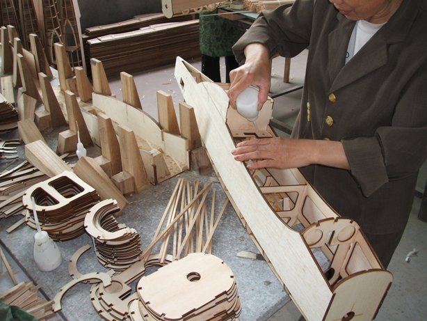

I have attached a couple of photos of the jigs used in the factory so you guys can see just how they are made. I saw no evidence of the sweatshops that we are led to believe these models are made in. Maybe my supplier is different from most, but I doubt it.

See!!! I WAS RIGHT!!! look in the 3 pictures and show me where is the glue???
They use glue fumes and the real wood glue is used in the ICBMs...No wonder the ARFs come apart in the air...

From what I saw during my visits they assemble the laser-cut parts dry first in the jig and THEN apply the glue. So you may not have seen glue in some of those pictures.
I have sold and flown many of the models from this particular factory, and have yet to witness or hear of a model coming apart in the air (unless it was a mid-air)
