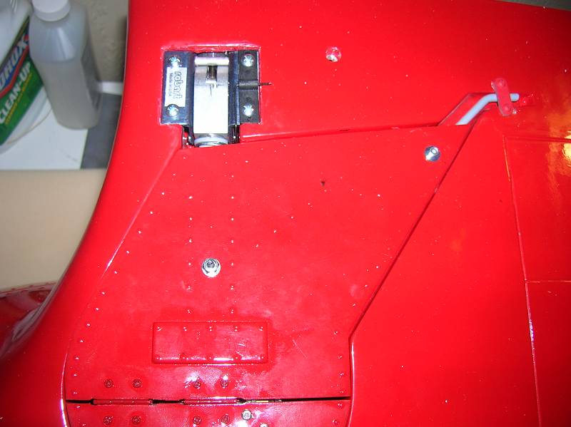

Default RE: Staggerwing Pics/Build

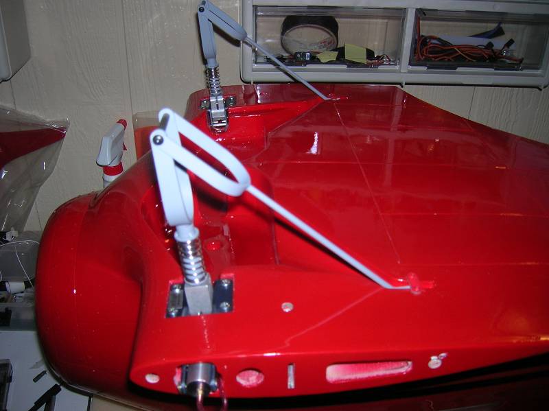

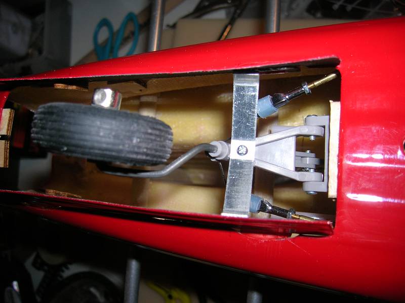

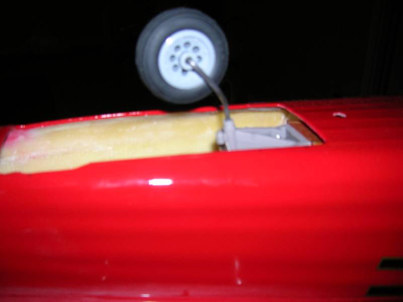

Here are some pics of the tail wheel retract. This can be operated by using a servo or a air cylinder purchased seperately from the gear. The pushrod housing is aligned perfectly and installed already for you. I bought the cylinder but after seeing how simple the servo would be to connect, I am going to use a servo and mix it in my radio. The gear doors are simple, just a little time sonsuming.

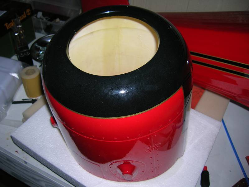

The main gear doors are already hinged and very acuurately detailed on the inside of the doors. Th cowling is beautiful and will accomodate most engines (in the range) without much butchering.

It does look like a top quality arf.
Are the retract bays large enough to hold 3 to 3 1/2" grass tires ?

Husker: Here is a pic of 4" Sullivan Skylite wheels. The wheel wells are plenty big. Unfortunately, these wheels will not fit the Robart gear b/c the wheels are too wide. \
Navy: The manual suggest the spinner back plate be 6" from the fire wall and the cowl is very roomy inside. I will have to measure the inside of the cowl and get back to you. You can probably tell by the pic above with the ruler.

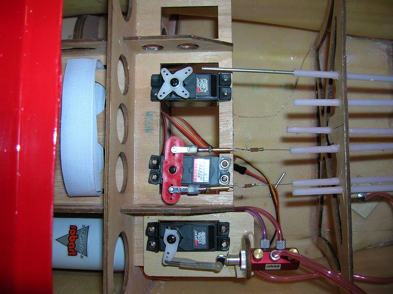

ANYWAY, back to the goods..........
I mounted my air valve stem under the belly and is easy to get to while sitting on the gear.
The pull/pull tailwheel is a no-brainer, but time consuming. Be sure you have connected all the tailwheel pushrod and pull/pull wires before installing the gear doors. It gets really tight back there after the doors are on. The pilot looks ok as well!

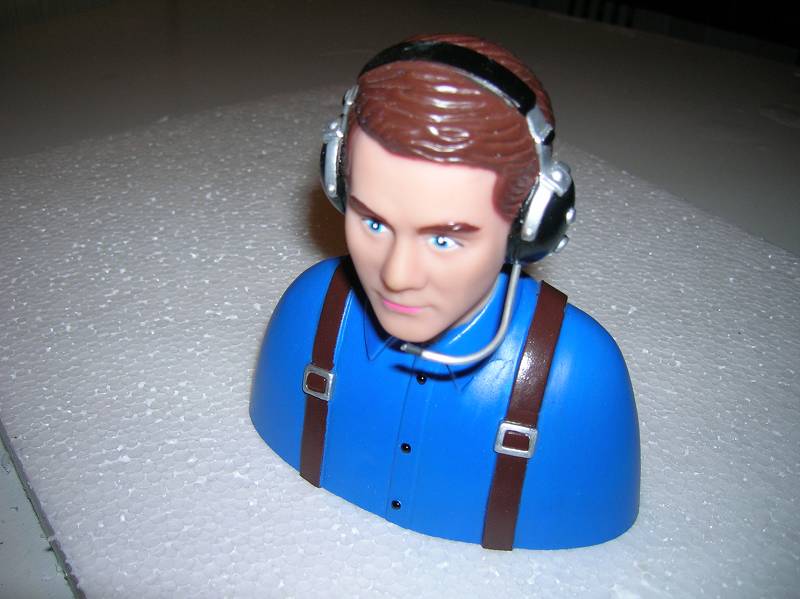

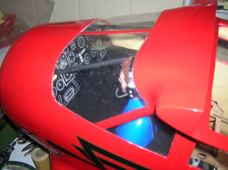

I usually only go for warbords but this plane looks like a beauty !!!!
Are you going to add any interior detail ? Dose the servo bay allow for more detail if the modeler chooses to go with a full interior ?
Thanks for answering because I cant tell from the pics

The kit comes with a black floor that slides into place with the pilot attached to the board. It is definately possible to add alot of detail, just not depth b/c the fuel tank is under the board. I will take some photos of it.

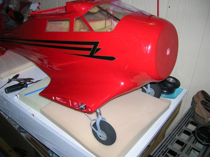

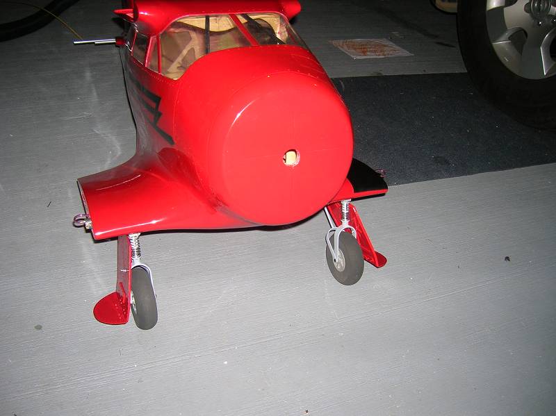

Turns out this thread should be strictly about the gear. The main gear doors go on somewhat easily, just a bit time consuming. You can see in the pic that gear down=GOOD, Gear up=BAD. I spent a while adjusting the doors to close flush. Also, the manual suggest drilling and tapping the gear strut. I found it easier to drill through the strut and then place the screw from the inside of the strut protruding through the outside of the door and then put a lock washer and nut on. On the wire that pulls the bottom of the door open/closed, simply bend the outside of it beside the place that it slides through at the 2 main screws. The manual has you get your dremel tool out and cut away a slot to put a wheel coller, simply bending the wire works and is ALOT less time consuming. Hopefully this info will help someone on their build. Now, what engine??

Hopefully these pics will explain the cockpit. The pieces are just dry fitted in place. I will paint all exposed wood grey or black. Also, there are two molded seat backs that will be in there.

Looks good , allows for as much or as little detail as you want

It would be easy to fabricate a new instrument panel and add guages and other goodies from Hobby Lobby.
Nice job, on the assembly. Thanks for showing us.

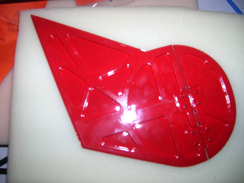

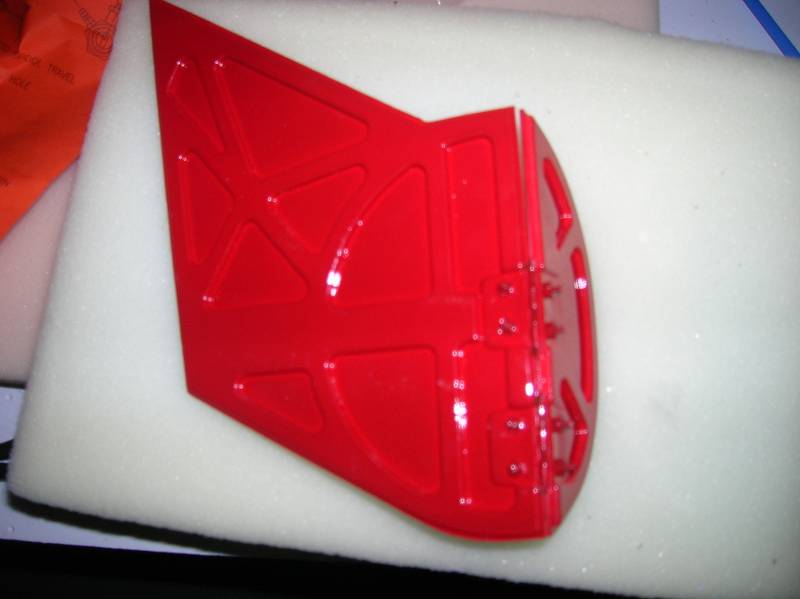

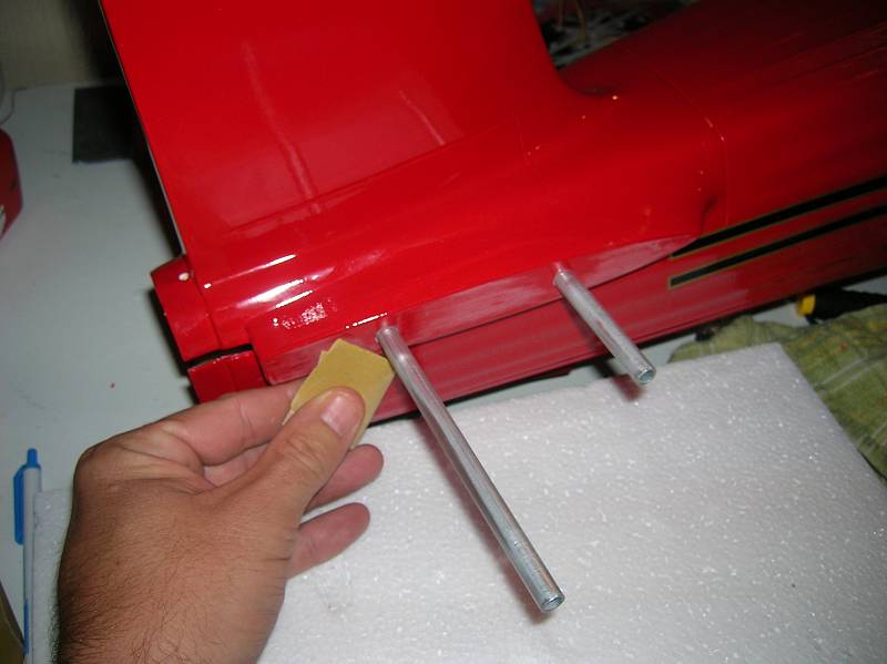

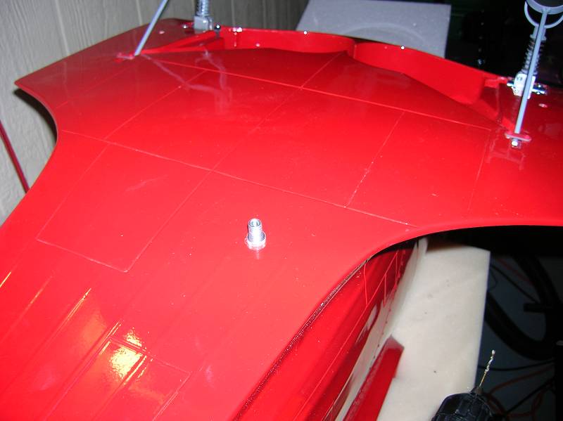

Well, it is moving along rather quickly now. The stabs slide on after after a little 80 grit. The cowl really makes it look huge, b/c it is really big!
