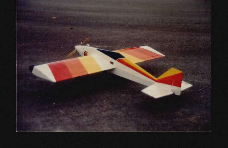

I got my plans for the SuperHots from MAN. It has a 54" wingspan. It is a one piece airplane(wings don't come apart), unlike Midwest's kitted 2 piece version.
The CG measures 2" back from the leading edge or at the deepest part of the cord.
There was no canopy for it, just trim it out in Monokote.
Fiberglass Specialties had a cowl for the SuperHots. You can make a balsa cowl easily and glass it.
I am making parts kits for a 33" version of the SuperHots for .074-.15 power and I will be making parts for the 54" .60 size original version too.
The pic is the 33" version with an OS .15 on it.
ZZ
