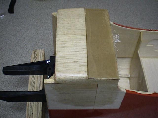

As for other mods, here is one that I just worked on today. I cut a recessed platform on the chin block to receive a set of 1/4scale Giles gears. I capped it with a layer of thin ply (1/64"?) and FG'ed over the area.
I'm not a big fan of wing mounted gears: harder to fix when broken and typically likes to nose over, especially when flown off grass. I don't much care for scale appearance for this aircraft, so I opted for better ground handling, and taller gear to clear the 16x6 prop I plan to use.

Here it is with one gear half. I cut the recess at a flatter angle than that of the chin block, which would have kicked the gears too far forward. This way, the wheels should be rright underneadth the LE when the wings are level.

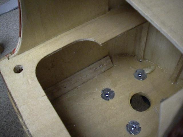

As for other mods, well, the sky's the limit. I'm trying not to go nuts on this one like I did with my WM Super Stunt 60. So Iwill limit myself to the main gear mod and other prudent reinforcements.
Here's a look at the back of the firewall, with some tri-stock and the usually fiberglass complement.
