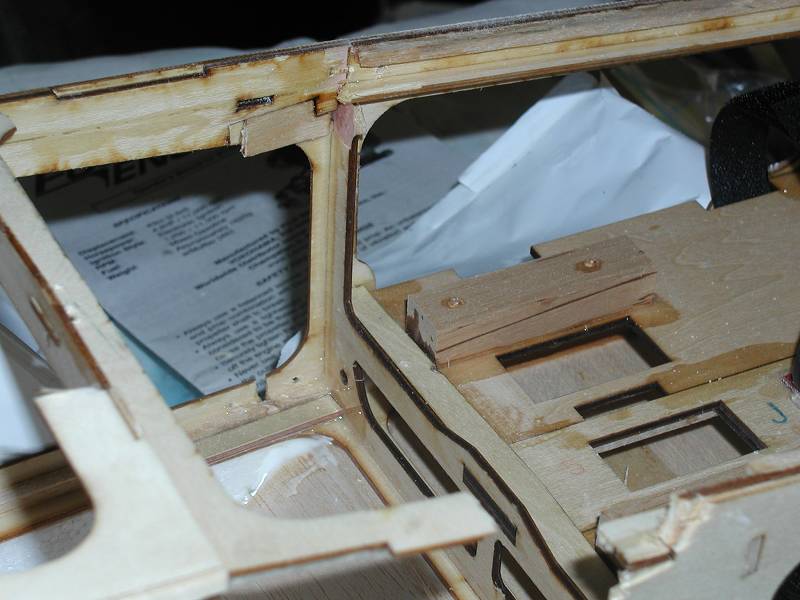

I did add tri-stock to the inside of the firewall during the build (as I do with any ARF).
Inside the top quarter of the firewall there is only foam behind the firewall. Did you glue the tri-stock to that?
And how did you get access past the fuel tank support that blocks off most of the fuselage a couple of inches from the firewall?

To get to the back of the firewall is a trick and a half.
See the bulkhead in the picture that's marked with the yellow "1." That supports to rear of the fuel tank. It's the first thing you have to get past.
The bulkhead that's marked with a yellow "2." and that's being repaired with the orange clamps supports the front of the fuel tank. And has even smaller lightening holes in it and they're not lined up with the one hole in the back bulkhead.
And the blurred area in the picture where the black "3." is where you've got to get to. That's where the liteply bulkhead is glued to the foam that's the front top of the fuselage. The foam is sheeted with something like 1/16 balsa. It's hidden by the covering fold.
BTW, that red cowling in the background is the original and it came through this "crash" in perfect shape. The 4 attachment screw holes were slightly affected. Notice the sharply defined failure line around the firewall remains. Matches the motor mount almost perfectly. That's one weakness of LitePly. It doesn't take compression worth spit. And you're going to tighten your motor mount to the firewall right?
The out of focus areas are there because the camera was on automatic focus and the distance to the back bulkhead and the firewall area were far enough from the middle bulkhead that the focus didn't cover them. An indication of how far it is inside that sucker from the back bulkhead to the firewall.

The tri-stock was added on the sides, not the top. Had to glue the tri-stock pieces to a small dowl and push it into the epoxy. Once the epoxy was dry, I snapped the dowl off. I then poured in more epoxy over the tri-stock at a 45 degree angle and layed the fuse on its side so the epoxy would coat the side walls of the fuse. This was all done through the fuel tank compartment.
You can see from this picture that I screwed spruce members on each side to front of the firewall. The screws go all the way into the tri-stock. These members sandwich the firewall between them and the tri-stock and replaced the blocks used attach the cowl.
