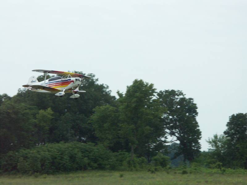

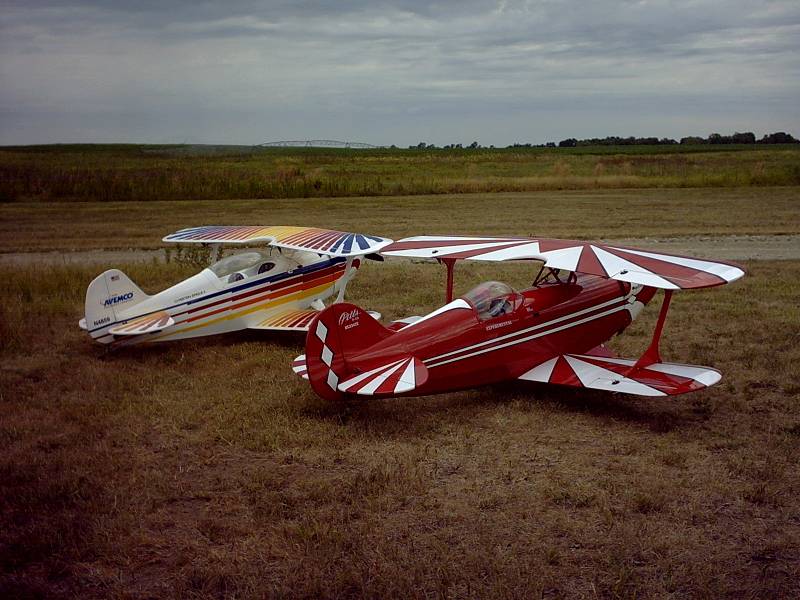

Hey I have a friend with the pitts and I have the Christen eagle He has a peguses 4 cyl in it flys great and sounds real cool. I have the Fuji 50 in mine there defenitly is a differance
His flys real scale like and is lighter. Mine flys with more authority but with more weight at 20pds. If cash is not a problem then go with the pegusus its real nice and you would not be dissapointed with it
