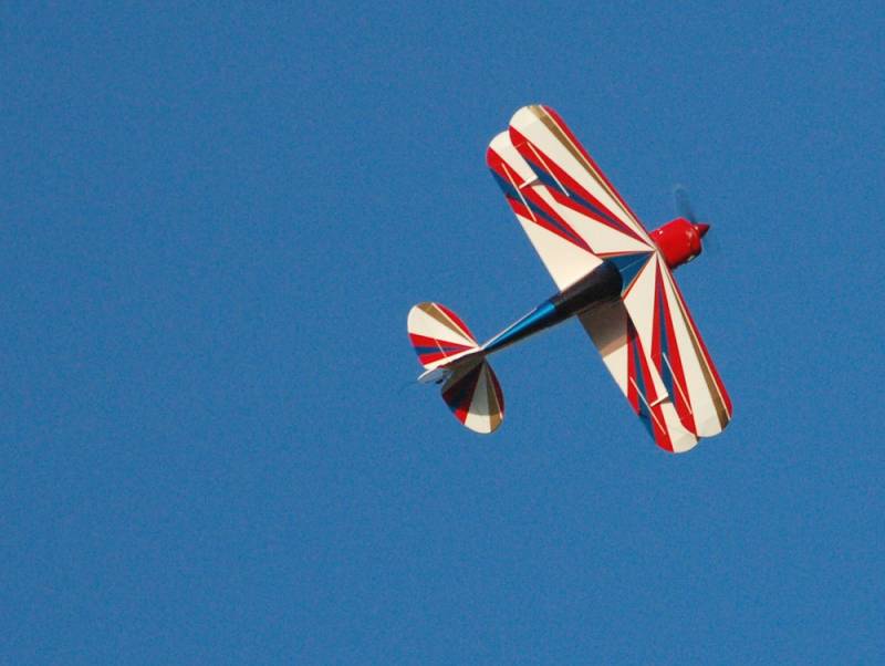

I've just finished my Super Skybolt with an OS 91fs and love it. It flies smooth and easy like a pattern plane and just settles in nice and slow on landings. Great aerobatics. It is currently my favorite plane to fly.

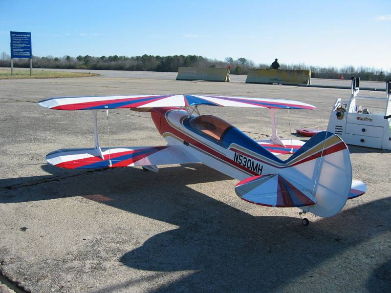

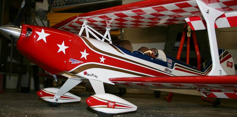

There are several at my field, including myself who own Skybolts. It is still my favorite plane out of many. I would buy another if something ever happened to mine.

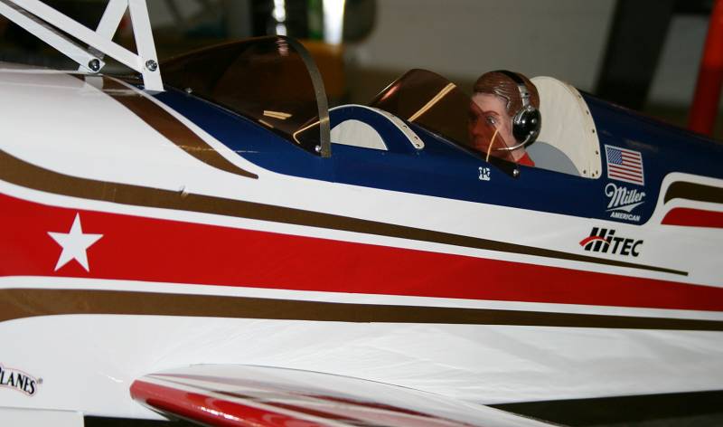

Maidened my Skybolt arf with a YS 110 yesterday. All I can say is WOW! Fly by at a crawl, slowly advance throttle to half and watch that baby get smaller and smaller at a 75 degree climb out. Landing? Better than my trainer ever landed. Sound of that YS 110- WWWWWOOOOOoooowwwww.
Spinning a Master Airscrew 14" X 7" three blade prop. Moved the tank back to the servo tray, strapped the battery to the tank, mounted the receiver next to the tank, mounted a smoke tank behind the firewall on a removable hatch door. Plane balanced with no ballast added.
