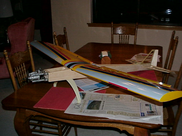

Does anyone like this plane? I have one ordered , but since then I have been reading alot of bad reviews. I want to put snow skis on for winter time. I picked this plane because of the thick leading edge. Thought it might have more drag and slow quicker on landing.
If you havent started building yet, send it back. It is an awful plane. I had one that I had to replace all of the hardware including the landing gear and motor mount. I had to cut the aileron arms off and install servos in the wings as there were no busing on the horns and the balsa quicly gave way, letting the horns flay around. The incidents were way wrong. It flew best with four popsicle sticks under the trailing edge of the wing, four washers under the top left motor mount, none on the bottom right with some under the other two corners, to give it a slight bit of right and down thrust. I had to use four oz of lead screwed on the bottom of the motor mount and this is with an O.@ 52 four stroke mounted on the long Dubro aluminum mounts. It flew with about 1/4" down elevator to fly level at mid range, but on flare out on landing, there wasn't enough up elevator to get it to settle in right. I bought a spare wing and found that it, not the orginal wing, had a different airfoil on the tip of one wing than the root of that half had. I could see a couple ribs where the rib was 1/4" away from the bottom sheating. The covering was awful. The fuel tank split open. After fighting it for a few months, my instructor tried to save me from running into a power line when I lost it on approach for landing, and he hit a wood rail fence. He felt bad and I was happy to be rid of that one. Send it back.

Don, Ihave already started building it. Ihave noticed that the engine doesn't look to have enough right or down angle when mounted.I have to say I'm not impressed with the hardware. I'm going to try to make the best of it for now.Don't think I'll buy another Lanier though.I'll let you the results in a few weeks. Thanks for the tips, looks like they might come in handy!

A few other things you may want to do.
I made a nylon bar that I used as a coupler to couple two rods for the elevator. Basicly a squae stick about 3x the square size. I drilled and tapped three 2-56 holes. The center one went to the servo and the two outter went to flex pushrods for each side of the elevator.
After a trunk crash, my flight box fell over on the tail and broke it- long story, I added 1/2" cord to the elevators. It helped the poor response at landing speed.
I replaced all the CA hinges with dubro pined hinges
After one hard landing, the main landing gear mount broke loose, It would be a good idea to add some re-enforcements around it. I used 3/8" square balsa epoxied in place in front and back, and over the sides.
I added a second layer to the wing hold down screw piece and then drilled and tapped to 1/4-20 and used nylon bolts vs the little steel bolts supplied
I also put a servo on each aileron, replacing the center servo and torsion links. I greatly improved setup.

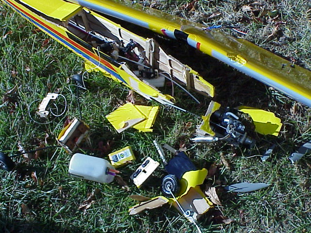

The three photos are the Explorer after a take-off stall, it's battle with the fence, and after making the new fuselage. The new design flew well. Sure sad I lost it.

Thanks, Bigedmustafa.The building pictures helped alot, because the manual with the plane is useless.The author seemed to like this plane.Maybe he works for lanier.We'll see! THANKS

Campgems, Good suggestions! I have a feeling I'll be needing them.I put the servo's and push rods in a few minutes ago.I've ,never had a model that used this twin elevator set-up , looks like they would have just joined the elevator halves together physically and used a single contol horn?.I have an eagle 2 that I fly from my backyard & I love it. When you look at the two there's no comparison in quality.I also just read that lanier bought out carl goldberg. Looked like the fence won, THANKS
The elevator push rod on mine had one side about 3/4" longer than the other. The rudder push rod didn't have any threads on either end so both went into the trash. The rudder push rod also hung on the rear bulkhead. You might want to check out yours before you get to far, just in case you have the same problem. I used golden rods in place of them and I Y'ed the elevator rods at the servo end. That worked out well.

I killed my explorer prior to soloing. My instructor and I managed to hit a fence made from rough cut 2x8s and really messed up the fuselage. I built a stick fuselage and used the Explorer wing and tail. It was a tail dragger. Man what an improvement. I really liked that plane, but one of the guys shot me down and it went into the creek bed behind our field and it was about four months before one of the guys found most of it. In the mean time, I built a clone of it. I had a spare Explorer wing and I built a second fuse to go with it. by now, I was flying with a O.S 52 four stroke. Just after getting this one flying I built a 4*60 and I ended up soloing with it. It only lasted me a couple months and I totaled it out. Shortly after that, I totaled out my clone. That holds the club record for most enging pieces after a crash. I destroyed the O.S 52. The only thing salvagable was the prop nuts and parts of the carb. One of the guys at the field had a 4*60 that someone had started but screwed up the wing on and we did some horse trading and I had it in the air for several months. I screwed up in a good wind oneday and miss judged air speed on a down wind leg and stalled it out and lost it. Then came the phoenix fun star.
