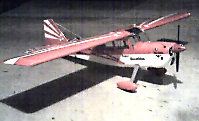

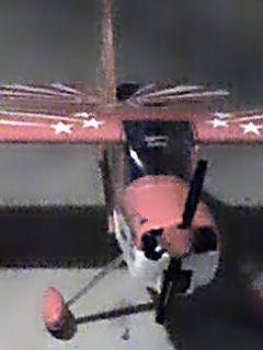

Finished my Decathlon last night! Hope to maiden when the weather clears and warms a bit. Attached a couple of quick snaps. Sorry for the poor quality. Taken at night under the carport with a cellphone!
