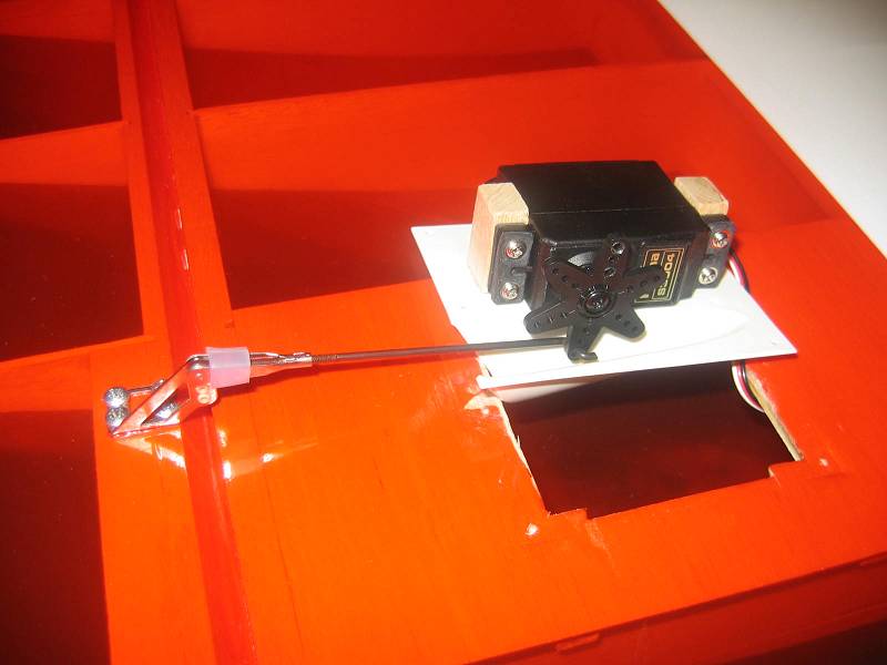

I set it up in my shop and gave it full aileron and tried to return it to level with my hand and it wouldn't budge a bit, I was afraid to give it anymore push than I allready had and it seems pretty strong to me. I will fly again next weekend and see if it repeats. Here are a few photos of the installation. Thanks again...Brian

From your photo, it looks like the servo control arm will bind with the control rod if you don't cut off the arms you don't need.

Thanks JC, I will cut them off before I put it back together. I think I will drop it one hole lower on the servo side to give me a little bit more leverage.....Brian
