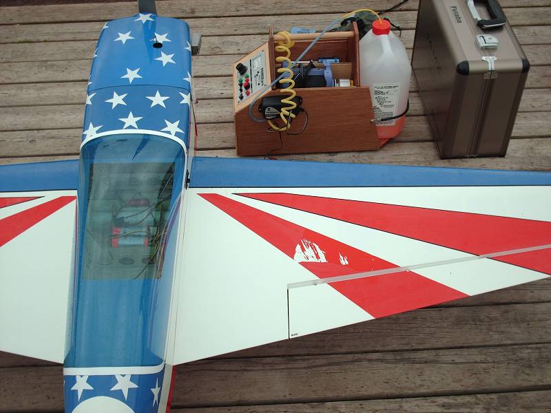

My extra is getting ligther and ligther for every fligth (as the covering falls of)
Its a great plane!!

Default RE: CMP Extra 140 questions (wing attachment)
Too bad about the covering!
