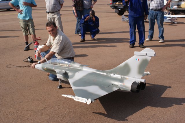

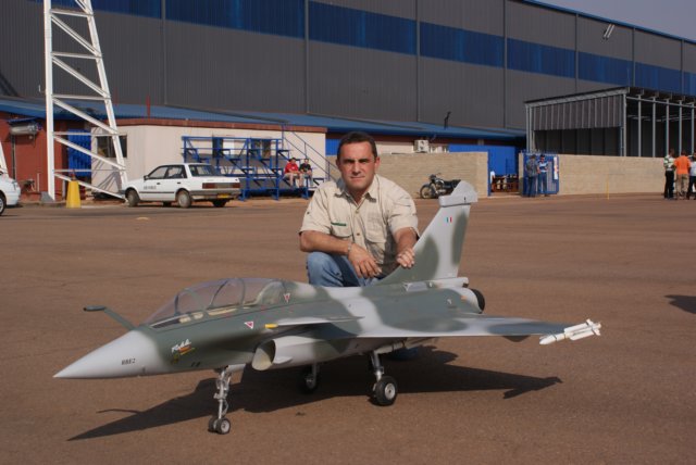

I would really be surprised by a torque problem, you would have felt it on the ground, your steering was ok ?
It is so painful to loose a brand new plane.....
Jet flying this week end :-))))
