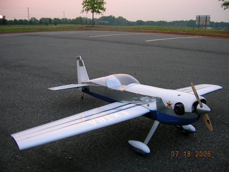

I had the Extra with a Tower .75 motor in it and I loved it. Blueman hasn't flown one with a Tower .75 so he doesn't know if it is TOO MUCH POWER! It's NOT!!!!! I kept both servos mounted in the rear of the plane to balance and that was all it took to counterbalance.
Here is a picture of it after a crash and I recovered it in White, Blue and Chrome. And some pictures to my original build:
Thread:[link=http://www.rcuniverse.com/forum/m_3071519/mpage_1/key_Phoenix%2CExtra%2C300S/tm.htm]Phoenix Extra 300S Build[/link]
