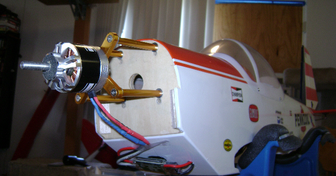

I am using a dualsky 5050CA-8 on 5s with a 14x10 prop. Almost 1000 watts on a 5lb 10oz. model. Flys really well. Even though my X mount pattern matched the firewall blind nut location, I had to re-drill 3/8" higher to center the motor in the cowling.

Here are a few pics!
