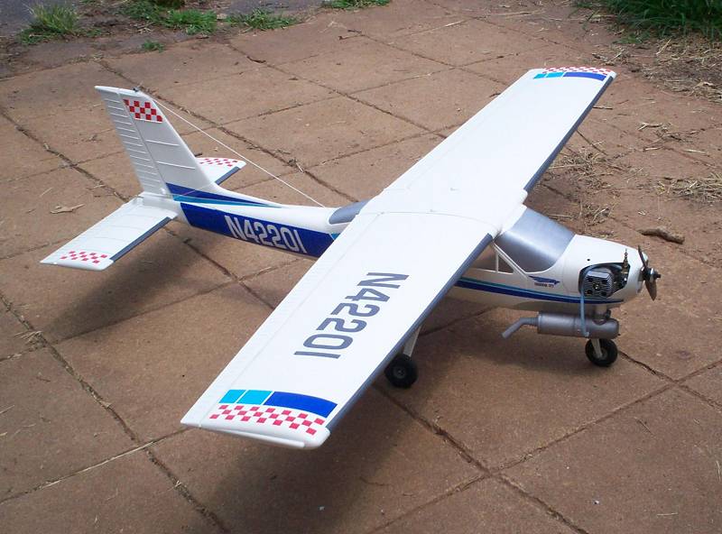

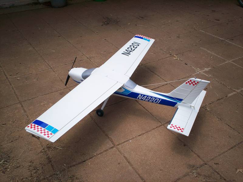

Was in the LHS the other day, wanted something to beat around with. The owner had a ModelFly Cessna 177 ARF on the shelf, been there a looooong time. He played the Godfather thing on me (made me an offer I couldn't refuse) and I took it and a SuperTigre .61 home, I already had Rx and servos from my recently defunct DR-1. One of our club members had a smaller version a couple years ago, it was a nice flyer. This one has a 66-1/2 inch wingspan, .60-size.
This whole plane is PLASTIC; well, the horizontal tail has a single balsa stick inside for a spar, but everything else is ABS. This one also has floats as well as wheels, so I have another floatplane now. It took about two quick evenings, and the thing was ready to fly (I put the wheels on to maiden it). I took it to the field, ran two tanks through it to break it in and get it tuned, and took off; boy howdy did it take off! This thing is a little rocket, and very responsive. It also flies very docile at 1/3 throttle, and the .61 with an 11-7 prop will take it straight up as long as you want to go. It lands pretty fast, but I'm going to program in some flaperons and see how slow I can get it.

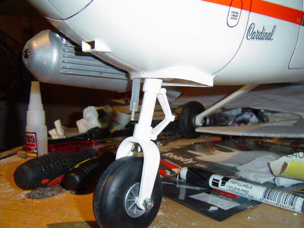

Needless to say, I'm impressed with this thing. The plastic skin is tough enough that you can really beat it around without worrying about hangar rash; the downside, I guess, is that when you do really ding it, it's more difficult to repair. The only thing I don't like is the big-***** muffler on the SuperTigre, it doesn't fit well on the plane (there is an indentation molded into the fuse for the muffler to sit) and this muffler interferes with the front struts for the floats. So....I spent a little more money today and ordered a Pitts style muffler for it. The ARF comes with a piece that fills in the indentation in case you use a Pitts muffler or mount a 4 stroke. I would have used a 4-stroke, but the only one I had available is a .91, too much power. But for what I gave for it, this is just what I was looking for--something to throw in the car when I don't have a lot of time to pack up the big stuff.

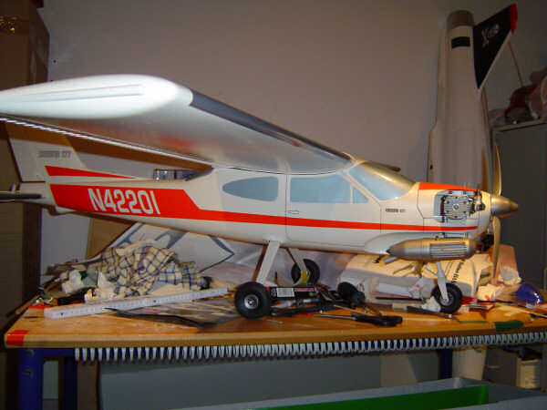

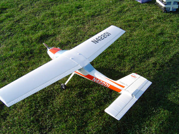

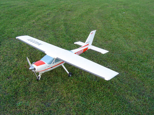

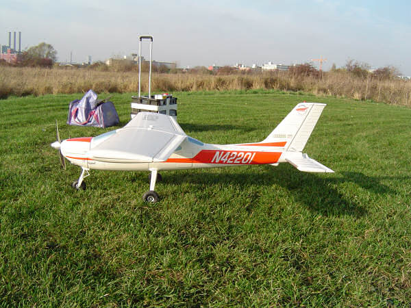

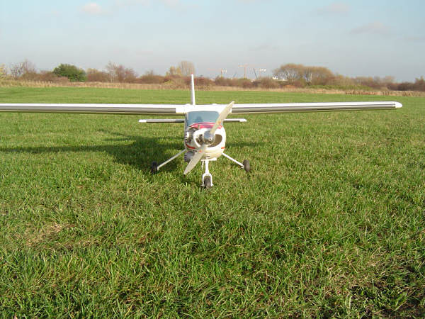

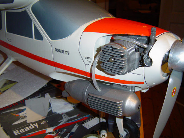

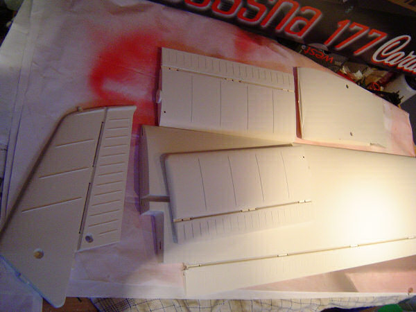

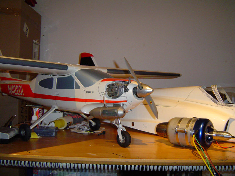

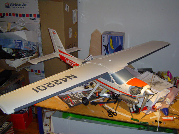

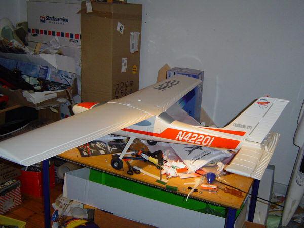

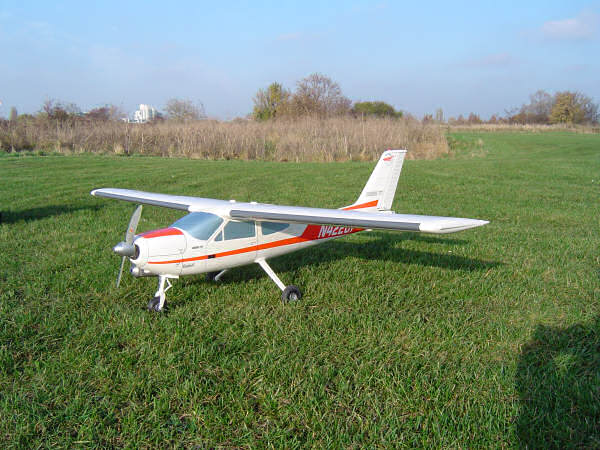

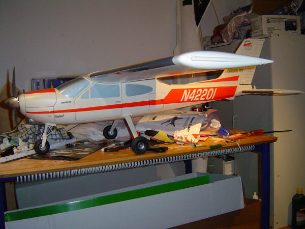

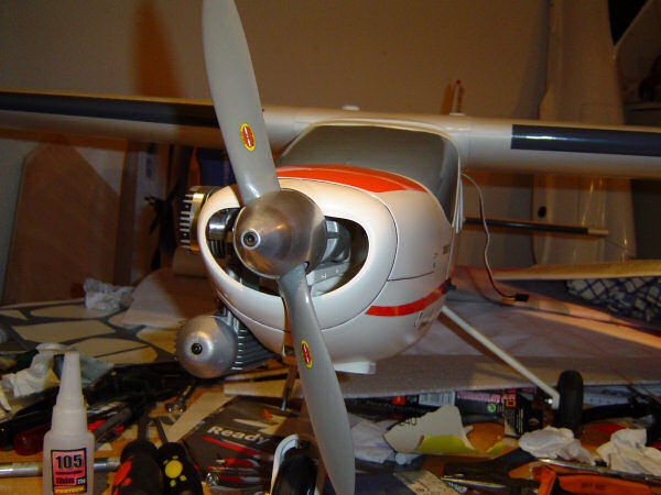

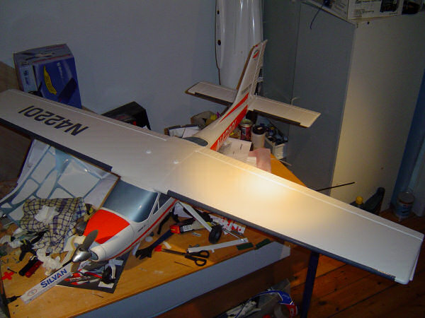

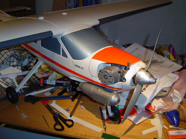

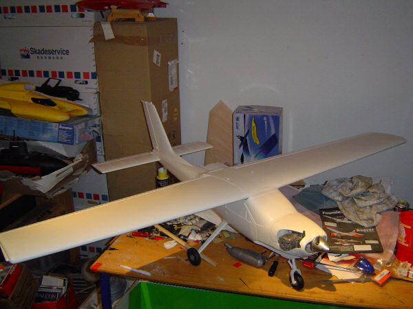

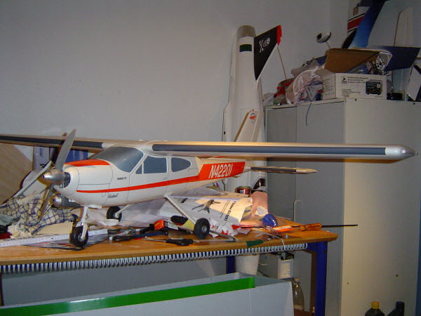

I love my cessna!
It still looks brand new after many many hours of flight.
No wrinkles in the covereing on this plastic ARF
Great performance with a magnum GP 65 2 stroke, but i have since installed a ASP 65 4 stroke....just for the better sound

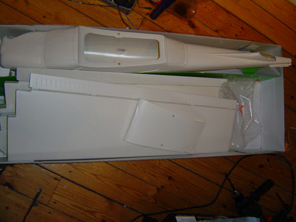

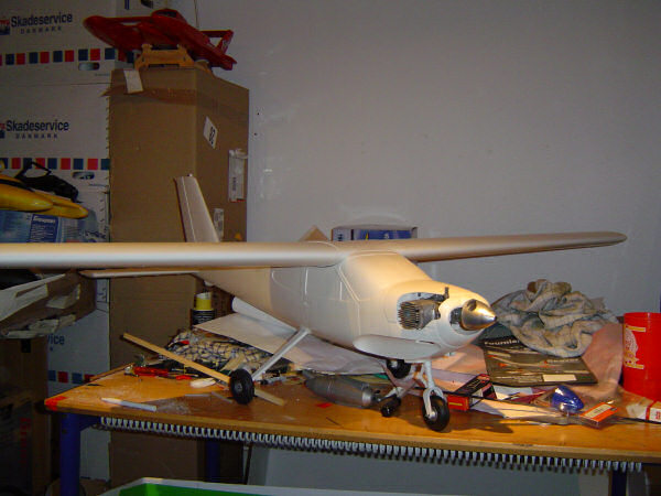

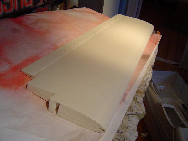

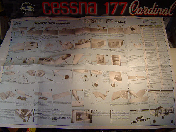

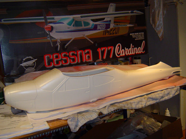

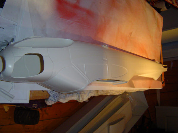

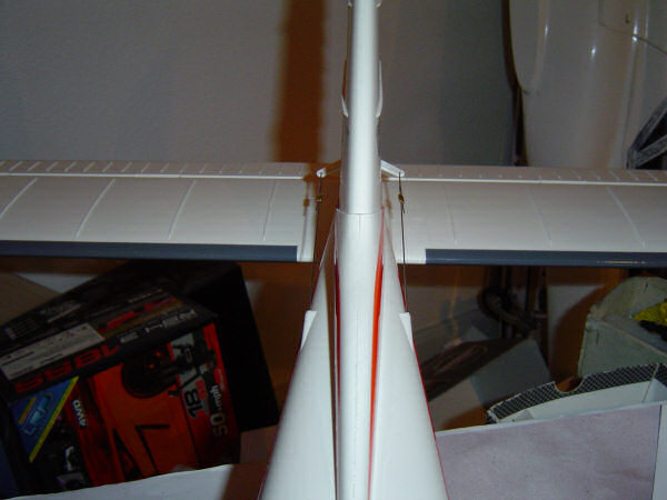

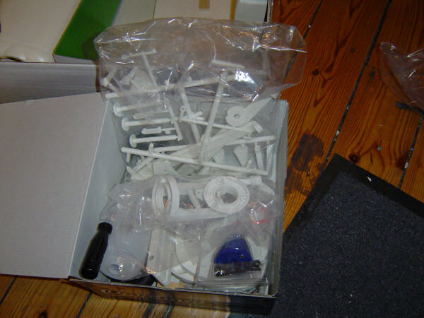

Pics of the kit

I like your red trim better than my blue. It was about 8 pm and kind of hazy when I was flying yesterday, and out past 300 yards, it was just a speck with nothing to show orientation. I plan to strip the stickers later and paint it in a red scheme I found on the Airliners website. I bought a TruTurn aluminum spinner for it, but the LHS didn't have the correct adapter for the prop shaft. I really wanted a 4 stroke, but was trying to get out as cheap as possible. Can't beat a .61 engine for $80. If I'd had a .72 at home, I would have used it.
Do you have flaperons programmed in? If so, does it slow it down much? This thing out to be a blast on floats, and with a little silicone sealer around the gear legs, pretty much waterproof. When you mount the floats, the nosewheel comes off and the front strut bracket screws in its place on the firewall. The water rudder is pull-pull and the wires go through the firewall, down the front strut, and back to the rear. That looked too busy for me, so I made a hatch on top of one float, right over the step, and buried a mini servo in the foam block that runs the length of the floats, and snaked a flex cable inside the float to the rear and hooked up the water rudder that way. Plugging in the servo should be a lot quicker than messing with the pull-pull wires. The hatch and cable exit got sealed with silicone. I'll probably leave it on floats most of the time during summer, we fly every week at our lake site.

Nice video, Sonnich. Enya was a good choice for soundtrack. too. Hopefully my Pitts muffler will get here today, and I can get the floats on (the SuperTigre muffler interferes with the front float struts). I'll try to video it at the lake.
