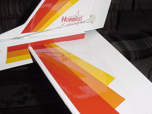

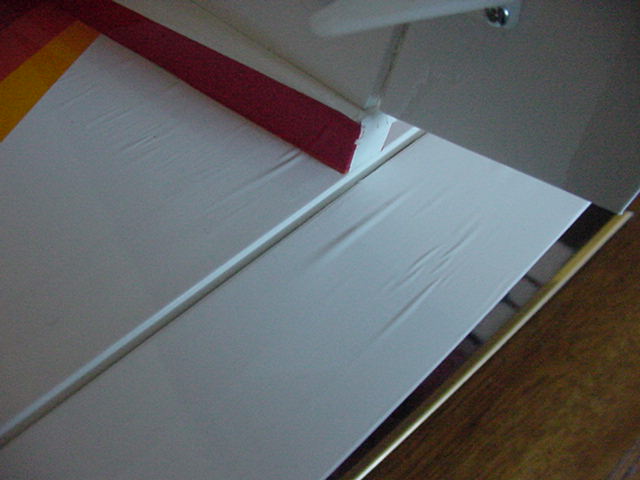

They come back when the Monikote cools.(on the elevator ONLY)
If I showed you the wing I don't think you would notice the marks so maybe i'm being to fussy and expected to much from the reshrink.
The tail section was the pits.
Look at the tail section.
This is the worst spot on the entire plane.
But it's the only spot that come back in a day or so.
How can I keep it from returning?
Am I being to fussy?
The wing is now drum skin tight

WB, it looks as if you have a sheet stab? When shrinking the covering on a sheeted surface, (stab, fuse, rudder, wing) you should put some pinholes (one or two) in the wrinkled areas before using the heat gun. What happens is the air inside heats up, and holds the covering away from the surface, then when it cools, the wrinkle comes back. This will also apply to smaller built up surfaces like stabs and rudders, that have little air space in them.
After it fits tight to the surface, go over it with an iron to stick the covering down.

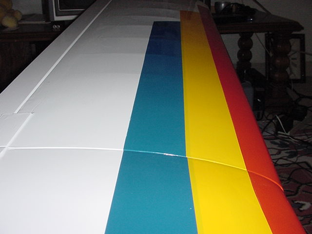

When I *HEAT* that part it goes away and leaves a very nice shiny smooth look.
A day later it comes back.
As for the wing I think because I heated the sheeted areas first,they loosened up and then I heated the rest of the wing between the ribs and that shrunk fast and pulled everything tight.++++++++++++++++++++++++++++++++++++++++++++ ++++QUESTION!!.

I wouldn't try to put any glue in it, as you'd probably end up with a real mess. As far as the needle size, just a sewing needle or small t-pin will work. The object is to let the air out as it's heated. If the wrinkle is coming back after a day, try ironing it down after you get the wrinkle out, which will allow the adhesive on the covering to stick to the wood, and might keep the wrinkles out.
You can only do so good on an ARF. All the ARFs I have messed with had some blemishes even after shrinking, usually around the edges due to mass-production type workmanship. The covering brand is also an issue. Some of the stuff they use requires some very high temperatures to shrink. Kyosho comes to mind here.
In the end it's probably impossible to make the covering perfect on an ARF, so the best you can do is pretty much all you can do short of recovering the plane.

First off, the adhesive on the back of the monokote is still ok ,dont use rubber cement etc! Secondly, if you've heated it up a few times with the gun and the wrinkles are returning, it's time to take out the iron. If you don't have the coverite version, I recommend it. Use a sock over the iron. Set the temp a little over 300 with the coverite thermometer. There is an art to getting the wrinkles out, you cant just smash them down. Heat up the covering adjacent to the wrinkles first, and then move the iron away from the wrinkle to push the excess covering away and redistribute it. The last place to iron is the wrinkled area. If there is a bubble, now is the time to stick it with a standard pin, not a medical needle, then gradually heat around the area, moving the iron and the trapped are towards the pinhole.
Sometimes I get the covering too hot and it puckers or wrinkles up. I find if I wait a week, the covering relaxes and I can go over the area again with the temp down a bit and smooth it out.
The key is to understand that you can shift the covering around a bit with the iron and then adhere the covering to the wood so the wrinkles wont return

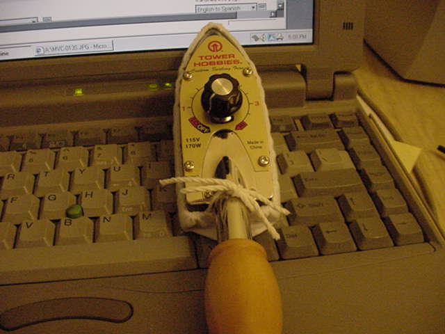

No my question is about the iron.
What is the coverite version, ???
I have the TH iron but for the price I can afford another one to do the job better.
But is it the shape ?
Temp settigs?
I have socks and it does get very warm but like you said I went the wrong way.
I plastered it right on the bad spot first.
Just for info I posted a PIC of the TH iron.
How do I know what a corvettet iron looks like?

The Coverite iron has a better shaped shoe than the TH. I use a Global, which also has a better shoe shape, and better point than your standard iron. It's great for getting into tight areas like between control surfaces, etc. Once you get one of these irons, your TH will be relegated to the tool drawer forever. It will be almost as good as discovering the wonders of a heat gun.

There's nothing wrong with the tower hobbies iron but the coverite one heats up quicker, has a nicer shaped shoe like he said, and is just a quality tool. You will like it. Get the little coverite thermometer while you're at it, it runs about $7 I think. Both are available at tower i believe. For now, use your tower iron and take your time and get your monokote technique down.

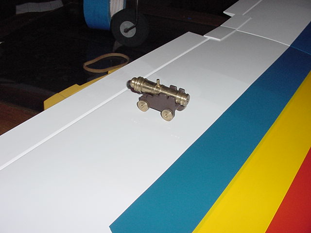

MonoKote will take more heat then the others but I think yesterday I almost blew a hole between 2 ribs.
The covering was being pushed in and then it got very soft with no warning and I pulled the gun away.
Look at my picture below.
Why the small cannon on the wing?
It's sitting between 2 ribs and weighs just under 3 pounds.
Look at the rib on the other side of it.
You can use this wing for a drum and I have the Guys above to thank and walk me throug,along with full page instructions.
This is the wing that was so bad I sent a PIC to TH and they replaced it.
Now with the help I received here I have a 100% flawless wing.

Originally posted by Whirley Bird
See that root section.?
It was at one time wrinkle hell.
Look at it now.
The whole wing is free of bubbles and wrinkles and drum skin tight

Originally posted by Aerohead
http://www.rcuniverse.com/attachment...&postid=761956
This is from last night.
I followed the instructions you Guys gave.
Now look at the picture after I did what you guys told me to do.
I know there is a tiny spot but this PIC is magnified 16 time bigger.
Copmpare it to last nights picture also at 16 times bigger.
Re: Re: Looking good!
The rest of the plane looks just as good not a bubble or wrinkle in sight.
What may look like wrinkles are light reflections.
The rest of the plane looks the same.
When I was heating the stab with the iron I heard the Monokote make a plucking sound several times.Good indication it WAS SHRINKING.
Again many thanks to to (Damnathius)(Aerohead)(birdnest)&(stick jammer) for all the tips and suggestions.
