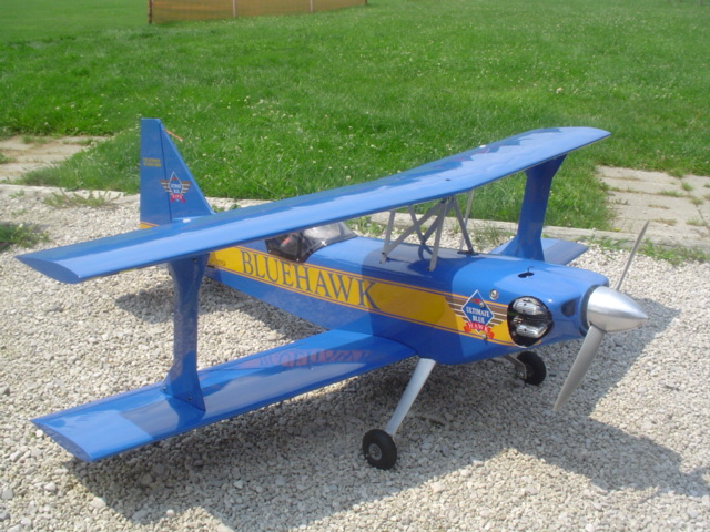

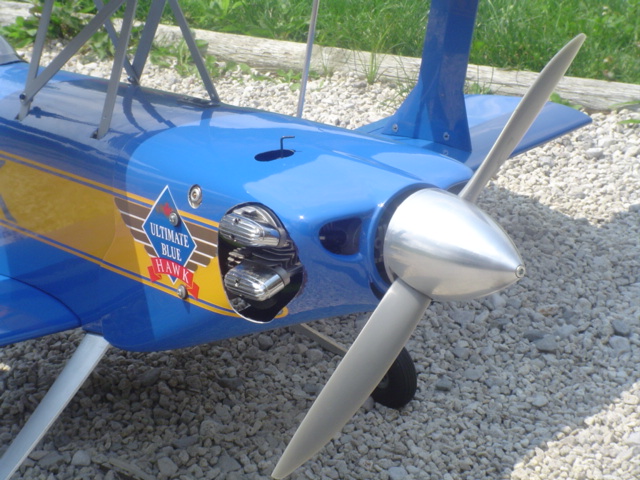

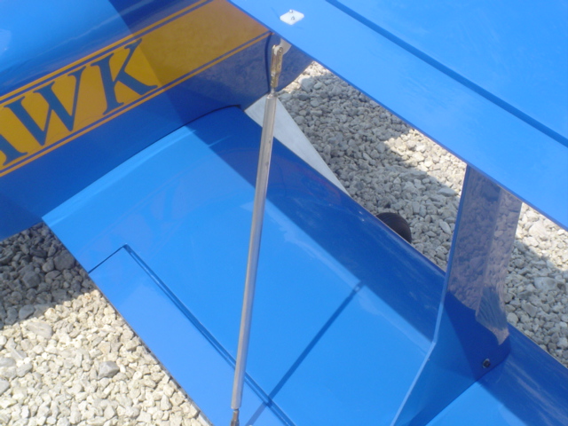

Flown mine all summer with a Satio 150 under the cowl, swinging a 17 X 6 prop. Plenty of power for knife edge loops and such. I have had three dead sticks with it due to mufflers coming loose. Absolutely no issues. The plane had a decent glide ( I would say above average for a bipe) and I was able to make the runway with ease each time. The Ultimate is aerodynamically clean for a bipe. She does pretty well without power, unless, of course, one has it balanced nose heavy. I was able to get the CG back with the servos and battery. I wouldn't put anything smaller than a 125 in her. But then, I like plenty of reserve power. Some aerobatics call for it.
The pictures were before I installed the wheel pants. She looks better now with them on.

I guess this is all relative. I'm at 600' asl, and think the 150 is about right on this plane. The Ultimate is capable of some of the more extreme aerobatics and the power the 150 offers dosen't leave much of this on the table. I guess it is all about how much of the Ultimates potential a guy wants to tap into.
Most bipes do have the glide ratio of a well trimmed Coke machine, but again, my Ultimate (when balanced properly) does have the best glide of any bipe I have had, which include, the Pitts, Christian Eagle, EAA, Liberty Sport, Weeks, Skybolt, Sopwith Pup, among others.

If you mount the engine sideways, there is no need for a Pitts muffler. Plenty of room to angle the stock one down to the gear and still be in the cowl.
