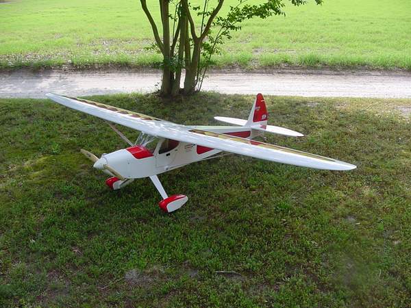

sigflyer's Avatar
Posts: 106
From: Benson, NC
Default Sigs 110" Rascal! Any one have one yet?
Finally finished mine. I used a MDS 1.48. No problem in construction and balance is dead on with no lead. I did find a crushed rib on the right wing panel. I called SIG and they have another wing kit on the way. ....Johnny
Old 05-19-2003 | 12:16 PM
  #34
My Feedback: (7)
Posts: 74
From: Morristown, TN
Default Crushed Rib
I had the same problem and call Sig. They immediately sent me a new wing. I got in in 2 days. I was very pleased with their quick response.
I have now seen 3 or 4 posts around where this same broken rib problem has happened.
Steve
