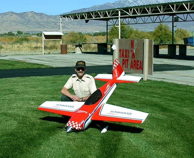

I started my gassers with the GP Patty Wagstaff Extra. It's one of the older ARF's and is a bit heavy as it's fully sheeted on a 78" wing span the wing loading is a bit high, but the model fly's extremely well when equipped with an adequate size engine in either a very large glow engine or a 50cc size gasser. The neat thing about Patty is that not only does the model fly lighter than it's weight might suggest, but since it's fully sheeted it will take quite a bit of punishment without breaking while you're learning to handle heavier, faster models. The downside to the lighter better perfoming 50cc size stuff is that they won't take as much abuse before making you pay the price.

Nice plane to! That is pretty much what I am looking to put in the air.
