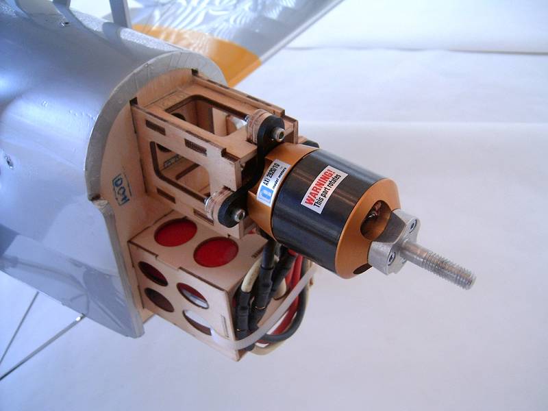

The wood motor mount included herein, in addition to having one side upside down, has inaccurate mounting holes for the recommended AXI 2820/10. I would recommend fitting the wood to the aluminum AXI mount BEFORE drilling to install blind nuts because you will otherwise end up (like I did) having to file the aluminum holes into slots to get it to fit. No harm done here, just an extra fifteen minutes of needless work and aggravation.

On your claim about the motor box, I've attached a photo of the model I was sent and the setup. Not a single bit of cutting to route the power system. Perfect fit of the AXI 2820 - absolutely perfect. Could it be possible that they changed the model at the factory in the year and a half between my receiving the airplane and you receiving yours? If your issue is with Hobby Lobby, then take it up with them. If the model changed between the review and yours arriving, there isn't a darned thing I can do about it!
