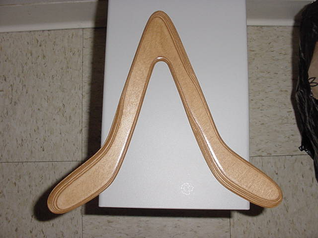

This is just one of my many wood projects.
Unlike the convential rang this has 3 airfoils.
Once I have it sanded silk smoth I use 0000 steel wool and water.
When it's dry I brush off any fiber I see sticking up.
I repeat this process until I no longer see any fibers then give it one thin coat of sealer.
The range is appx 50 yards and it flyes very well.
A bit OT but I wanted to show it off
