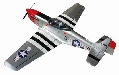

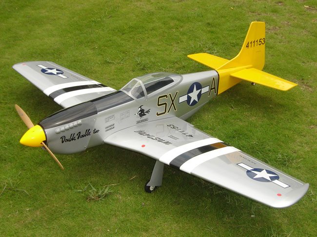

Here are a couple of ARFs that I am considering but the information on the website it oesnt say who makes either one of them.
Anybody familiar with one/both ofthese planes? They are both 60 size.

Generic Chinese arfs sold by several online sellers.

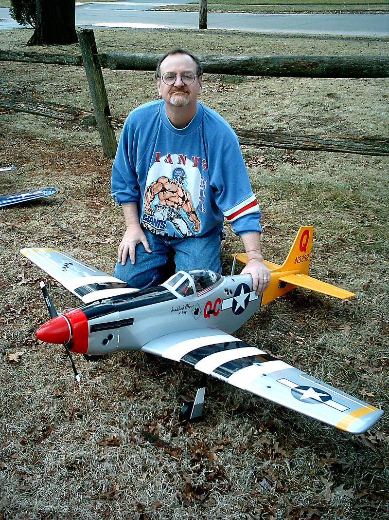

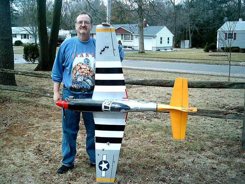

I bought a 60 size mustang that was a copy of the Hangar 9 Marie version from www.AK-models.com for around $120 and had very good luck with it. I beleive Nitroplanes sells the same plane. It built pretty much like the Hangar 9 version and flew great. I considered it an excellent value for the money. The guys at the field couldn't tell it apart from a Hangar 9. The one thing I did do, was replace the retracts supplied with a set of Hangar 9 retracts as the retracts that came with the kit didn't look like they would hold up.

The one on the right is a photo of the Will Hobbies P-51, in either .46 or .60 size.

I bought and built the Nitro Planes yellow tailed 60 size version. I did not fly it, I sold it as soon as I got it assembled. I know some of the generic ARFs are not much, but this one was pretty awful. Maybe I just got a bad one, but that is my experience with that particular model. Lots of poorly glued joints, but that was fixable, the fiberglass work was the worst I have seen, uneven, irregular thickness, FB parts fit was quite bad. It came with retracts, which I installed, but I can't testify as to how well they worked. The installation was not a "drop in", lots of fitting required.
I don't recommend it. There are better ones out there.
