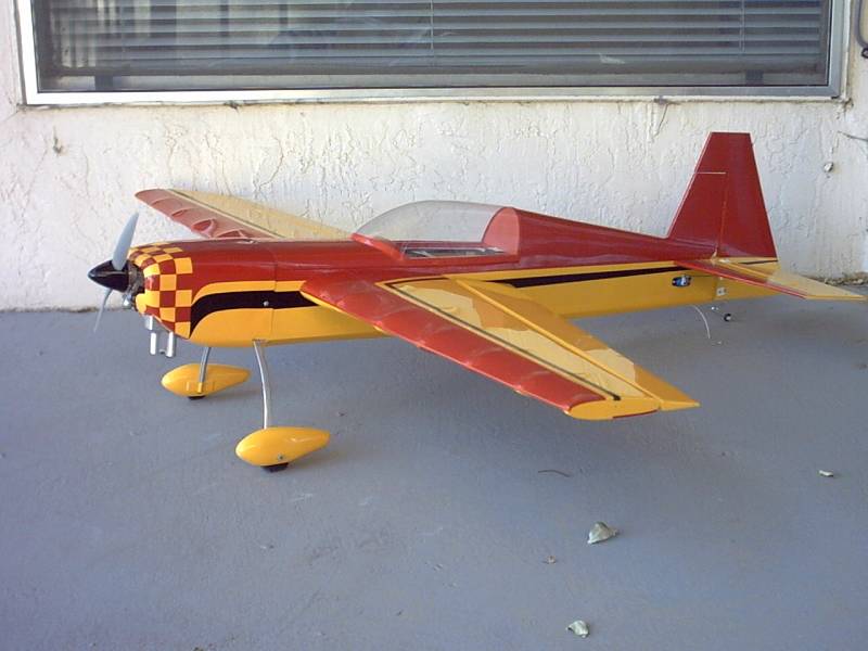

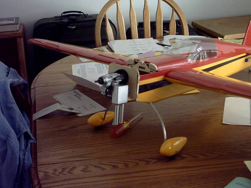

Horizon sells a Seagull Extra 300 electric that I converted to glow. Just added a thin piece of ply to the fire wall and removed all the electric mounting stuff. I have a OS.15CVA, 8/4apc and a 4oz. Tank. Flys good. I did it sort of as a joke but nice little plane .

Nice Extra, Thanks for the pics, I'll look up the specs on that. I like the looks of Goldbergs new Laser 200 45" ARF. If its about the same size I may look into it. Anyone else have any suggestions?

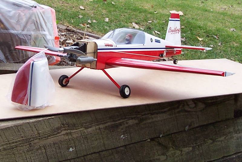

I put an OS.15LA in this little Global Wattage Ultimate Bipe a few years ago. Like Cyclic Hardover,,, it was sorta half for a joke and half boredom. Turned out to be a killer flying little acrobat. Just don't get it too far out of sight.[:-]

I kept saying, I'd like to take one of these and stick a glow in it. After a couple years of saying this, I did it. I have 4 flights on it and no regrets.
The CG is dead on and I usually fly my planes a tad nose heavy, this balanced out right on the money and acts weird so I may add some nose weight to see what happens. I had a T6 once like this and straightend out after I added a bit.

Hey Cyclic Hardover, where did you get the pitts muffler for your CV-A at? Link if possible would be greatly apreciated.

ORIGINAL: Mr67Stang
http://www.jtecrc.com/
I had one problem with it at no fault of Jtec, Since I mounted the engine inverted, the screw holes inthe muffler were off a bit. They were more than happy to patch up and re drill the holes. The whole service with Jtec was great .
