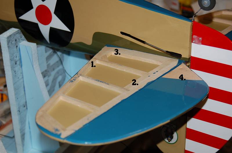

Flying it a few weeks back, the stab/elevator fluttered in flight. Turns out the LE had failed (1. in the uploaded image). It was lousy wood and failed right where the excellent LE reinforcement ended spanwise. Had the ARF worker any experience he'd have rejected the LE wood and found some decently hard stock. And the solid elevator (4. in the image) being the heaviest part of the tail crushed itself underneath the horn. I've reinforced the works (last picture) and have flown it since. It's a good flyer.
