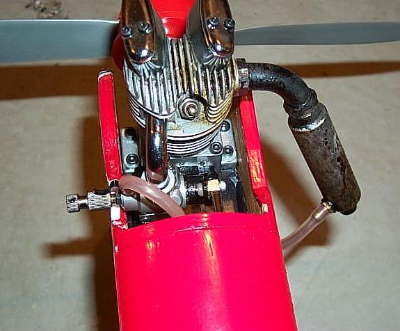

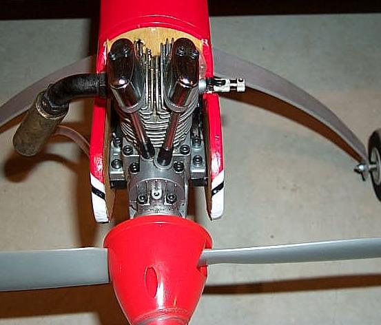

For those considering this combination, here's how the setup looks like. Not much (any) room for right thrust w/o cutting into the cheek panels.
However, flying w/ APC 13x4W @ 10800 rpm peak, it hovers fine w/o right thrust at about half throttle. I do have the battery pack under the stab, and balances at 4.75" behind LE, empty tank.

Can you say *snug*?
