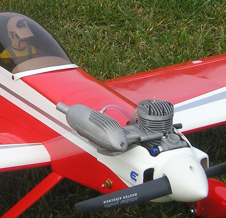

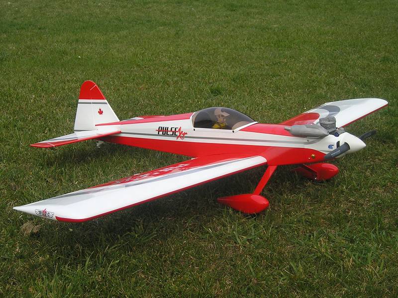

absolutely a wonderful airplane
mine has an evolution 46 w/11x6 master airscrew scimitar - and it'll do everything l want it to - and stuff that other pilots have asked it to as well
lots of power, quiet, etc, etc, etc
an electric flyer pal loved it - but couldnt afford the $ to equip one - so went and got a mini-pulse - everyone loves it as well
so all in all a winning design and plane - a step up from a basic trainer but it'll do well for that purpose and beyond
everything standard - i.e servos - hs425bb's, control horns, spinner, hinges, etc
only real mod's were the tail wheel mount, and the axles -- as noted by RO347 - l think he and l chatted about that a long while ago on a similar thread - so am glad to see he is enjoying his
AND l missed re-enforcing the landing gear mount area inside the fuse - and of course should have known better after having the same issue on a funtana and a showtime -- and of course finally that caught up with me on a tough landing - no real damage but a pain to repair
the funtana and showtime each have their own qualities - both for and against -- but the pulse offers me the most overall fun and enjoyment CONSISTENTLY

agree with ro347 - 11x5 or 11x6
l forgot to order a prop with my engine so went to LHS - and they were out of "regular" props - the gent recommended the Master Airscrew Scimitar - definitely looks like it has and does have a SHARPER bite - but also is a very quiet prop - no real noise from it - the gent it'd make the engine sound like a 4 stroke and it pretty much does
l started with and have stayed with 11x6 quite happily
with the evo 46 and 11x6 - l fly 12 minutes and still have 1/3 to 1/2 tank fuel left!!!!!
side note 1 - take it gentle and slow carving out the cowl to fit - little bits at a time - even if it takes 3 times longer than you want it to - the end product will look like a factory installation cowl and everyone will love you for it!!!
side note2 - l put mine together, set up surfaces and servos, checked c of g - bang on, started the engine and away l went and a year later still going strong - no set up, no trim adjustments - just fuel it and go!!!!
