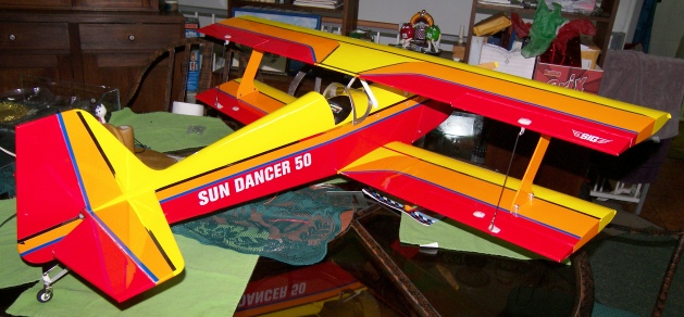

This one won't finish until in the new year but I thought I'd share what I have done so far. It will get a screaming 2C, best way to make a bipe "seem" fast. Thinking about .55 AX but not decided yet. Anyone looking for a small bipe.. this is your ticket, great looking little ARF.
Sorry pics waaay too big! Have to net size them first. will try again.

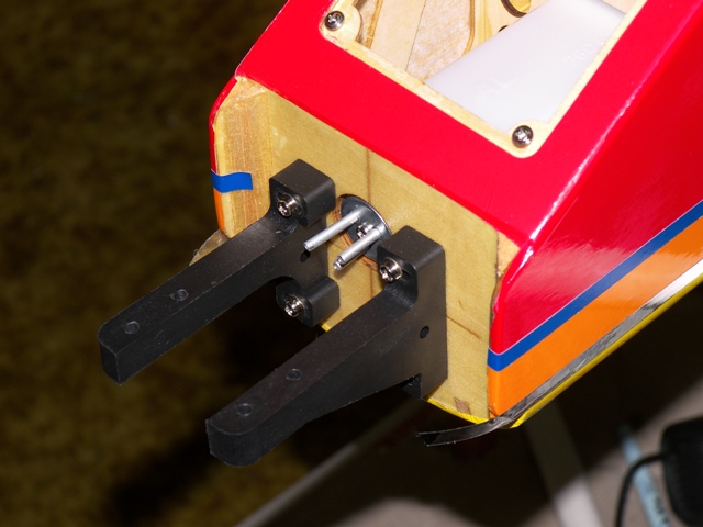

Old 12-02-2007 | 06:42 PM
Joined: Nov 2004
Posts: 92
From: Port of Spain, TRINIDAD AND TOBAGO
Default RE: Sig Sundancer 50 ARF
Still trying to decide which engine..... Hmmm.. a .61..... (NAUGHTY THOUGHTS)[>:] LOLOL That would really make my Sundancer rock! I've started dressing it up a bit. Here are a couple pics. Question is just how much engine can this cutie-pie take?
ID:	817111   Click image for larger version
ID:	817112   Click image for larger version

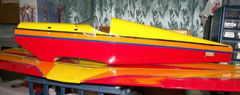

A little progress. The fuel tank is the same shape as my Mayhem but it is rotated 90 degrees... I don't know what Sig was thinking. The curve should be down so you get the last of the fuel centered in the tank for as long a flight as possible, go figure. Anyway I made my own little retainer for the tank and here it is. The engine mounting holes have been drilled using a 46AX as a template for the 55.
ID:	823863   Click image for larger version
ID:	823864   Click image for larger version

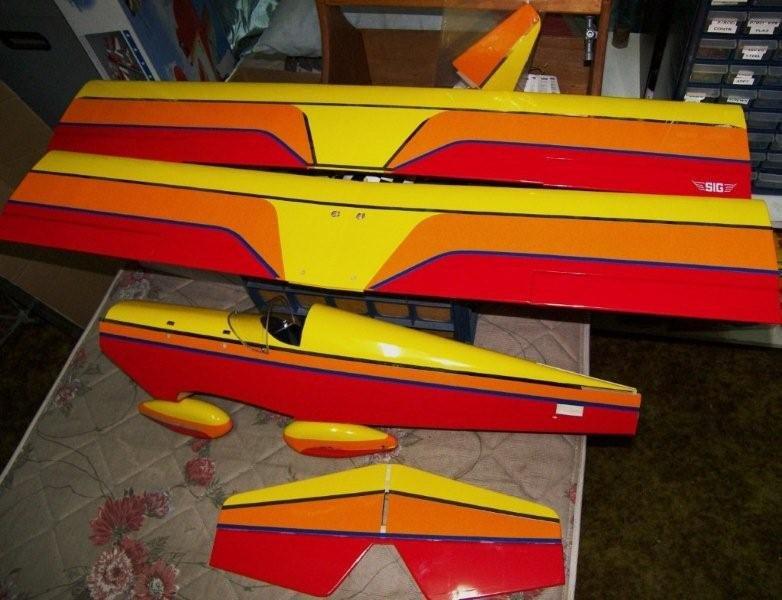

Old 12-26-2007 | 12:10 AM
Joined: Nov 2004
Posts: 92
Merry Christmas everybody!
Very quiet in here. With the OS 55AX side mounted I have a problem with my tank height.
Old 02-03-2008 | 01:13 PM
Joined: Nov 2004
Posts: 92

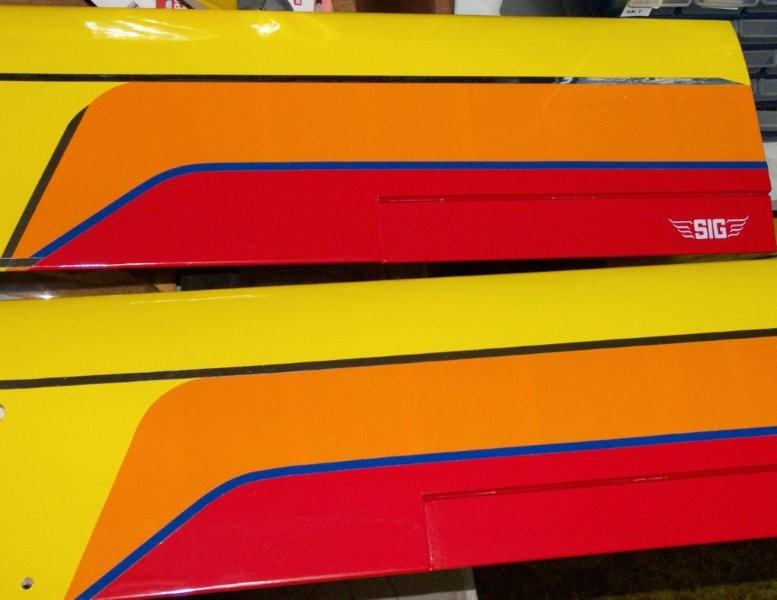

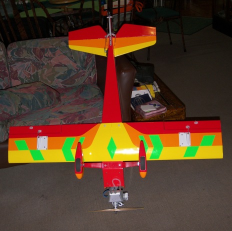

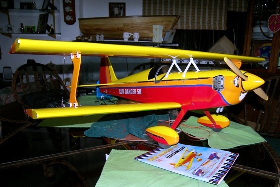

Looks like this thread has gone to sleep, I'll post the finish anyway.
Weight-6 lbs. CG was on the mark, no weight added using OS 55AX with a 12x6 prop to start. Had to do some markings on the bottom for easy differentiation. We'll see how the maiden goes.
Not as difficult a build as you would think. Wing alignment was a breeze thank God.
The covering material quality is below Sig standard, I've put the iron on it twice already for loose corners and edges.
I think she's Georgeous! "Muy Caliente" !!

A buddy took some really nice photos of the maiden and posted them here.
http://rcpix.fotopic.net/c1460910.html
Because of the tank height I will need a pump but all else went very well.
