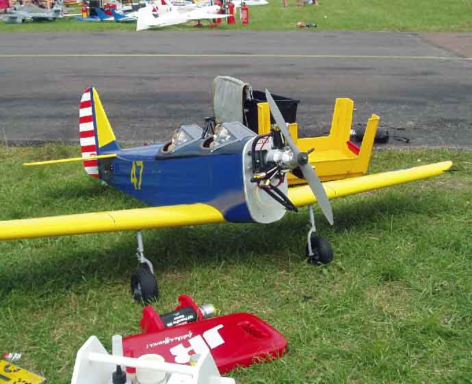

a note on transport my friend made a fake wing center section thing so he could put an old landing gear on it for holding the fuse while in transport. it will do the stuff mentioned above just not with pazzaz. if its your first bigger model and you plan on -like- aerobatics get something else is all. if you want it as a warbird its good.

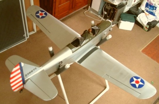

a note on cosmetics if you look at the numbers on the sides of the two different models that have pictures here. the one just above has light-nonmatching in color numbers. This was very big dissapointment that my freind had. I guess they appear to match before you apply them so you may want to get you own numbers. look at the pics posted you will see.

Thanks for the photos, Robotech and Schmacka.

Originally I had the #47 that came with the plane but later changed them to #34. I had my sticker guy cut some vinyl stickers that are much bolder and brighter. He also cut a silohette of a dancing woman that I put just under the front pilot along with my wife's nickname.(see picture above.)
Tip: If you put your wife's name on 'em she won't mind them as much and you can get more of them.
I used the #34 because our city was a major pilot training center during WWII and that was the field #. Lots of PT19's flying around all day and night.
I also replaced the original whells with 4.5" Dubros and lost a bunch of weight. I bet those Robart struts are sweet, the stock gear are a little spindley looking.
