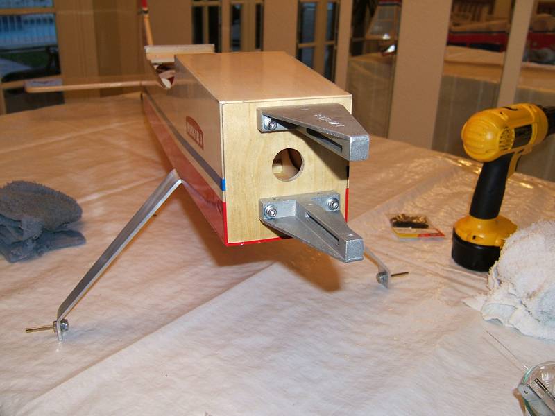

thanks for your replies I guess I won't worry about the wing to much then.I did do the firewall thing I cut the nose back 2.5 inches and used aluminum angle and 4-40 flathead screws and aircraft nuts.I don't think I'll have a problem with the firewall.Now I'm just waiting on a opto kill switch and I'll be able to go fly this badboy.

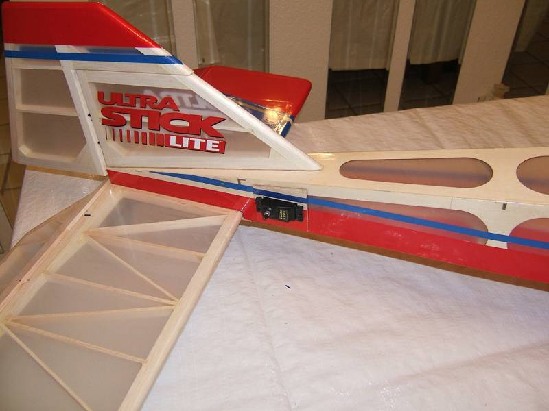

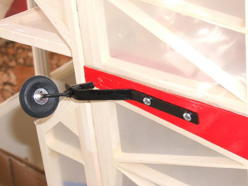

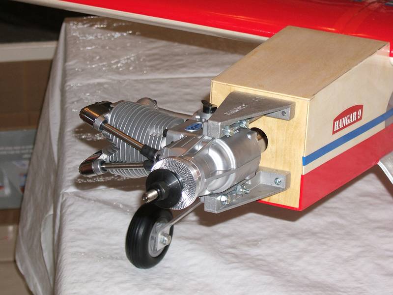

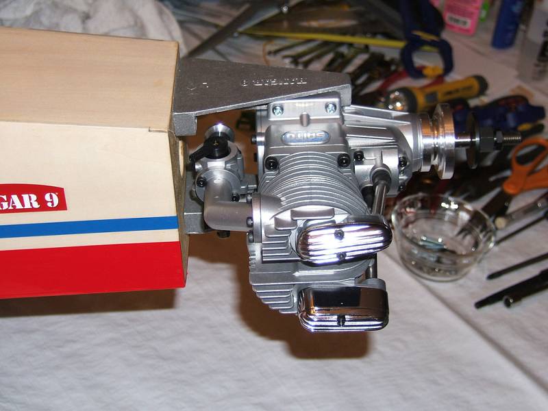

Here is the progress I’m making towards my maiden. As you can see I've beefed-up the tail wheel areas. I have moved my rudder and elevator servos to the rear of my plane to offset some of the Saito 220's weight. I moved the top engine mount up 3/8" for the engine width and to help with the prop clearance.

rccrippen,
what did you do to beefup the landing gear?I don't like the clear ultra cote either but, I got in a hurry to fly this plane so I'll just have to live with it,I did however recover the fuse.I wish these companies would offer ARC's as well as ARF's they would make a little more money off of us too!We would have to buy covering materials from them.Of course we would also see some of the lousy workmanship some of them have.

Jim,
I use 1/2 in triangle stock and fiberglass cloth, I use the landing gear itself to mark the hole placement in
the cloth, cut those out about a 1/4 in. in dia. Cut your cloth to cover the entire area you want to strengthen,
plus about 1/2 in. extra. Take some 30 min. epoxy and coat the entire area with it. Not to thick, but thick enough
to soak into the cloth. Lay your cloth down in the area you have chosen, pushing into the corners and everywhere
till you have good contact throughout. Then apply some more epoxy on top of that, and work that in, soaking the
cloth thoroughly. Don't get to much epoxy, you'll know what looks about right. Then cut the triangle stock the
length of the sides and front and back. Place those in position, once again with the epoxy and glue them in place.
press them in nice and firm. Let it dry over nite and presto! your done!
I've NEVER had any area I've done this to fail. And out of the crashes I've seen when this was done to a plane, that
was the area that held together.
Rick

So your doing this work inside the plane, in the original landing gear area?
I'm just kind of unclear of where your actually doing this "beef-up". The landing gear on my US120 already has triangle stock in the landing gear area along the sides???

When glassing any cloth, only use enough epoxy to wet the cloth. You should plainly see and feel the texture of the cloth easily. Too much epoxy will greatly weaken the process. Another way to do it is to wet the cloth first then "squeegee" out the excess resin and lay the cloth into your work area. This is done easily with narrow strips and fingers!

Pappy's correct, I 'm a Material Bonder for Bell Helicopter here in Tx. I wrote that on the fly at 4 AM before work.
Use just enough to wet the material good. I use something called 956, But I've used the epoxy with the same results.
As for the stock, on this particular plane there is two small pieces on each side. I added more across the front
and back. I also have used square and rectangle stock when in a pinch. There are no hard and fast rules as
to what you have to use. I've even replaced the wood the gear mounts to with a piece of Oak, but if it's reinforced
enough/correctly, that should'nt be necessary. Wieght is only the real thing you have to watch, and in less your
one of the 3D guys that count every 1/2 ounce your really not going to make that much of a difference.
