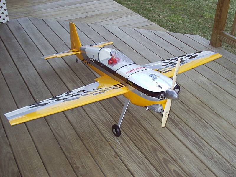

As promised...............

Nice kitty......[&:]

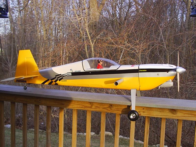

This animal is all ready to go. I just have to wait for a really nice day to maiden it. Damn, I didn't pay a lot of cash for this plane but the time and effort in building her really makes me nervous to fly it but I'm surly looking forward to it. It turned out to be a real sweet looker.............

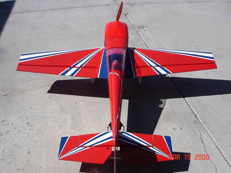

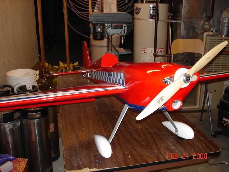

Old 02-21-2008 | 05:38 AM
  #31
Joined: Jan 2007
Posts: 12
From: Riverton, UT
Default RE: WillHobby Extra 330 1.4 ARF

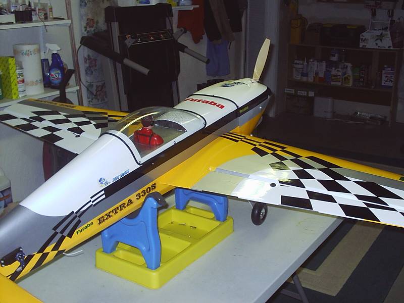

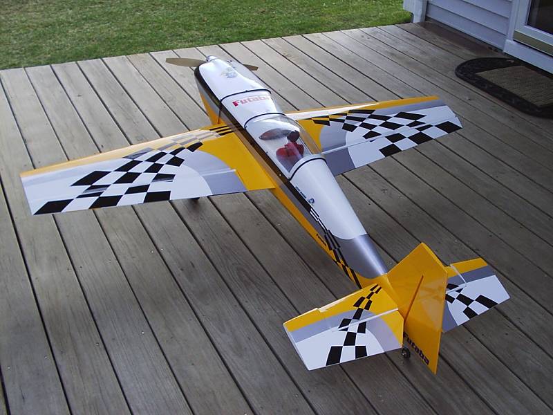

Hope everyone is still around. Willhobby seems to have disappeared, and I cant even find them anymore. Mine is nearing completion, and it will deffinetly be done for this season.

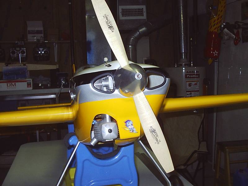

My SPE has about an hour and a half run time, and is really breaking in nicely. Im getting 7200 rpm on an 18x6 skorpea prop. Would like to find a 17x8! Breaking in the engine is finding all those nuts and bolts that need a little lock-tite! Hopfuly this weekend I might put a flight on it. I will let you know.

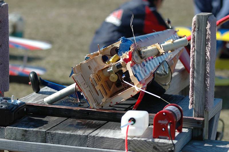

Bad news, the right aileron came loose and fluttered the right wing off the plane completely. Result was a slam into the ground pretty hard. I flew it twice before the third fatal time and it actually flew and landed pretty good. I think the CA hinges that come with it are inferior. If you haven't already, make sure those hinges are in there good. Next time I'm gonna use better ones because its actually a very nice plane. Worst thing about it is the time I spent making this plane exceptional looking and made it a very neat build, too bad I didn't realize the hinges sucked. Lesson learned........

Sorry to hear that Brian. Yes, I pretty much threw all of the hardware and hinges away that came with the kit. Didnt like anything I saw, even the wheels I replaced. I have spent alot of time trying to break in my SPE. Its running really good, but the breakin oil Im using makes a mess. I have one flight on mine. I was going nuts, and wanted to see it in the air. It was windy and cold, and I shouldn't have flown it, but I did. It flew great, for what short time I had it in the air. It even landed well, but I had quite a head wind to slow it down. I will let you know after a few more flights. I saw that Willhobby planes are back on Ebay! Hope they do better this time. Im still very happy with the model for the money. Its just not for an inexperienced builder. mgmarty.

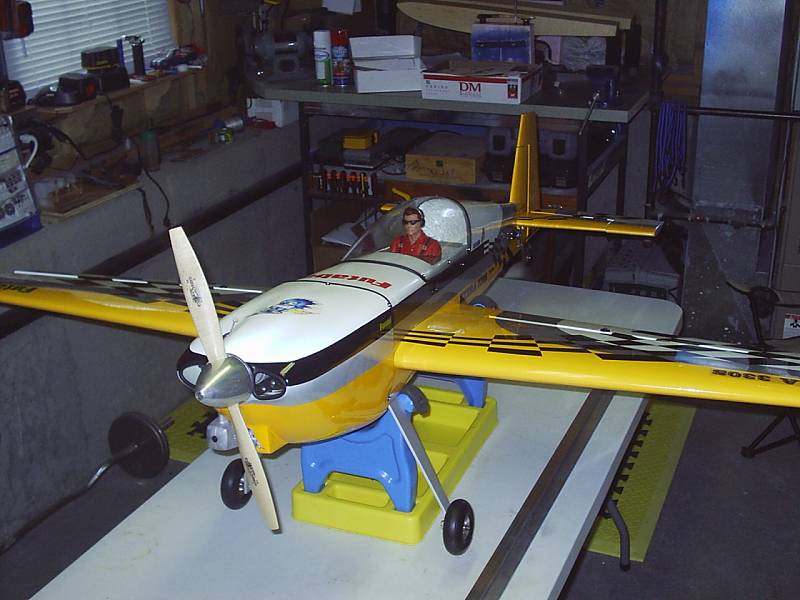

Got another one. Thought it would be the same in every way but this one is actually a lot better quality and improved design. The covering is a lot nicer and seems more durable. The first flight on the red one and the covering was lifting up on the wing. That may have even caused the crash. The throttle servo location is a lot easier to get to as well as the wing screws. I'm
using Radio South CA hinges on this one:

looks very nice!! Glad to hear that they fixed those wing bolts. I still only have the one flight on mine, and this weekend sounds like a good weather day to try and fly. I will keep you posted. [8D]

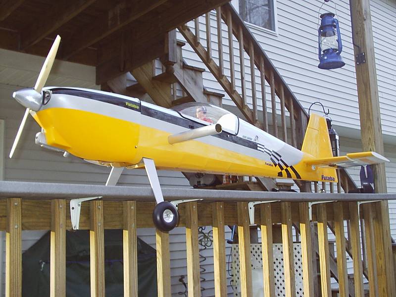

It's ready to go. i had to add quite a bit of weight to the nose but its perfectly balanced. I used Radio South hinges this time and there's no play at all on any of the surfaces. The weather sucks right now so I don't know when it will fly but I'll let you know B-

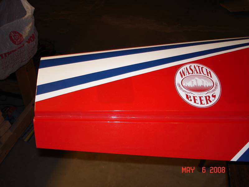

I have been flying mine when weather permits. My engine has about two hours run time on it, and next time out I plan to run some good synthetic oil, and lean it out. I'm still very happy with the plane, wouldnt hesitate to buy another. Yes, throw away the hardware package that comes with the plane. I used none of it. I agree with Guerra, seal those hinge gaps. I always have. I use ultra coat of matching color, it is easy.
Its spring here too, and weather has really sucked for flying. Gusty winds and cold as hell. I get out when I can. Let me know how it goes Brainiax. mgmarty.
