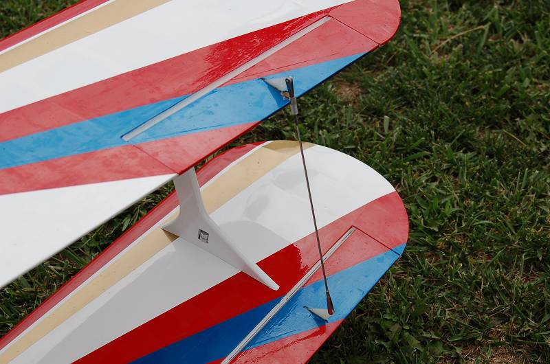

Not a weak area, but something worth considering.......... see the picture of the aileron rigging. There is a long thread about this model that includes a discussion about that. I'd suggest doing it, mostly because I was the one who figured it out. The airplane obviously flies good with the mfg supplied stuff and design. The original discussion covers that and more. Mine flies without any problems. And that rigging actually took less time to do than it would have their way.
It's one heck of a good airplane. They all have warts from the ARF mfg's. These are little ones and can be easily cured.
