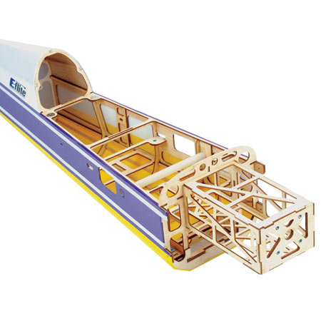

ORIGINAL: SFMMcoasters
I really want to convert this to glow! http://www.horizonhobby.com/Products...ProdID=EFL2475
Take a look at the pic below of the motorbox and you'll likely change your mind.
Sure it could be reinforced, but then its heavy.
I'm also guessing that the box sticks out too far forward for a decent glow set-up without major surgery.
The rest of the fuse is very lightly built too.
There's probably much better Extra 260 glow options out there.

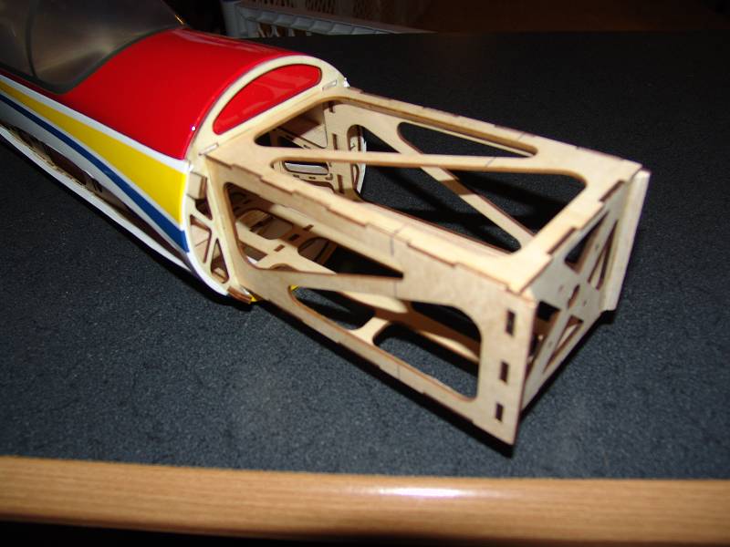

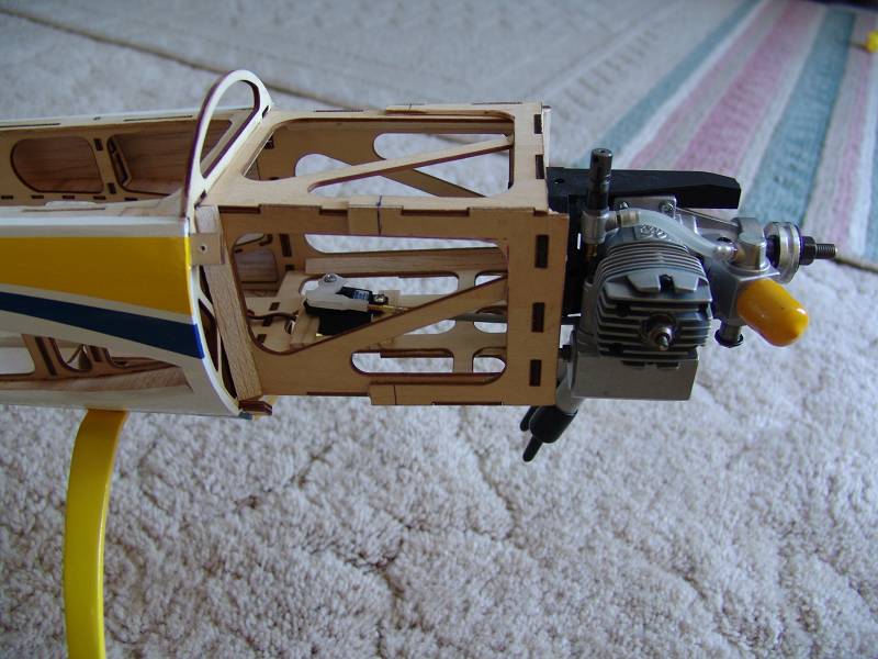

Agreed. It would be nice to have such a forum. I just converted a Quique Yak to run with a .32 SX. I can fly all day and only have to stop to fuel. The plane weighs 54oz RTF. The electric version is about 52oz RTF. Ran mine tonight and it hovers at 1/3 throttle with a very hard full throttle accelerate.

I would slap a .25 FX on that thing so fast it would make your head spin.

I believe any size nitro engine would beat that plane to death. I have that plane and it is built extremely light and fragile. I wont be buying another one. Flies good though.
I would stay away from the park480 size planes for glow conversions. They are usually built way to light to handle glow engines. Stick to the 10 to 30 size electrics and you might have better luck.
just my thought on it though...good luck!

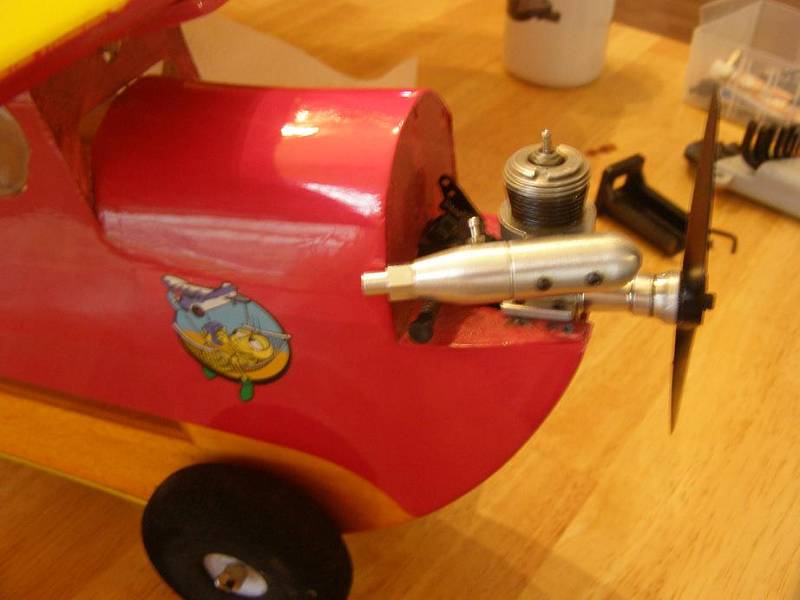

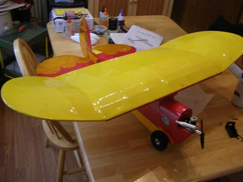

I'm currently working on a thow together conversion of a Clancy Lazy Bee Electric ARF Just to see if I can do it. Ya, I know. Not exactly an exciting plane but I just cant stand to have a complete airframe just lying around. I have retrofited a plywood mount for the Cox .074 Queen Bee engine and in true Cox form it spews castor oil all over the plane... I love it. I will fly it untill the oil soaked wood gives way
