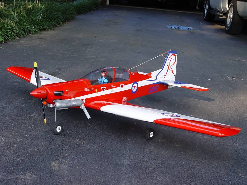

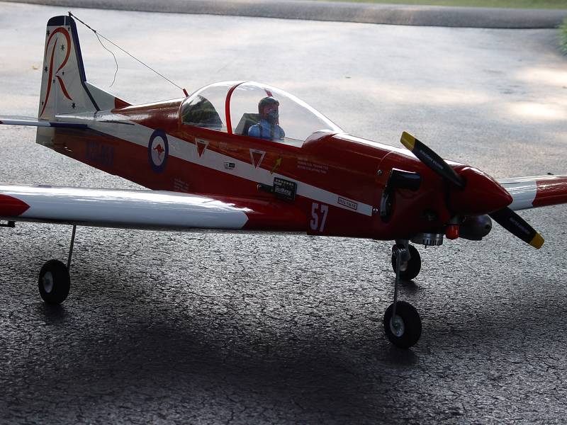

I would also recommend that you do something with the color on the bottom of the wings as it is very difficult to distinguish between top and bottom when in the air.
Here is what I did to mine.
