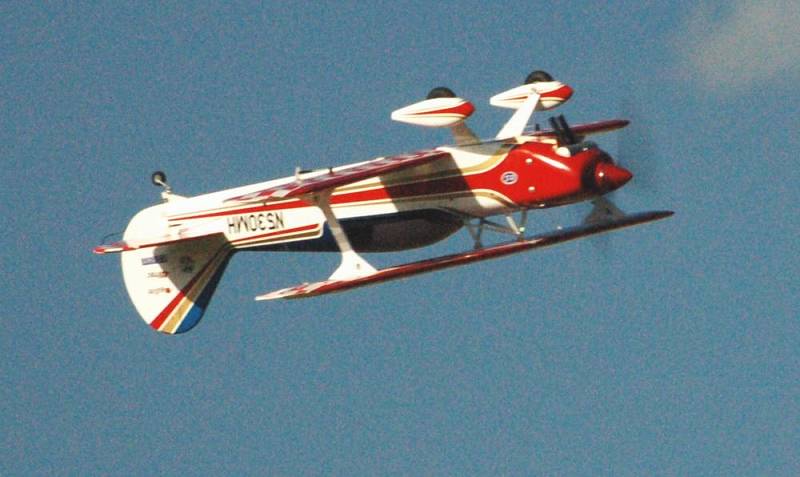

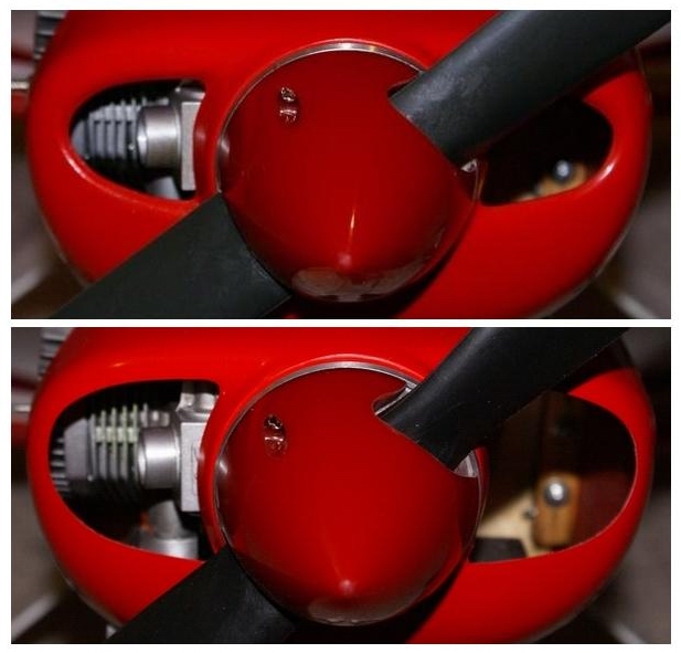

I powered mine with the OS 1.20 AX. Even though it's a larger engine, it fits just fine under the cowl. I did reinforce the firewall at the time of construction (nearly two years ago) and have had hundreds of trouble free flights. It is no understatement how good this plane flies. Two other pilots at my field have also powered their Super Skybolts with the OS 1.20 AX with complete satisfaction. The second photo shows the before and after of how I increased the cowl opening for better engine cooling

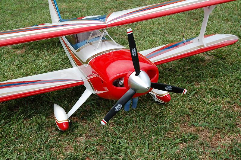

The pictures of the firewall also include the cowling in the background. It's not very sharp in the picture but it's quite interesting. When we walked up to the airplane, everyone thought that nothing was damaged. The cowling was almost perfect. The attachment bolt holes were slightly cracked, but that was it.
The cowling looked perfect. The impact was gentle enough that nothing really happened to the cowling. It's flying today. Matter of fact, here is a picture of the airplane last time out. That's the cowling that came in the ARF box. Notice any damage? The bolt holes have been reinforced inside to reinforce them. But that cowling stopped the engine from moving back any farther after the firewall failed completely.
The firewall failed completely in a situation that did nothing more than cosmetic damage to the fiberglass cowl. That is an issue no matter what engine you choose. BTW, that is the original OS61 in the picture. It's been in the airplane since day one.

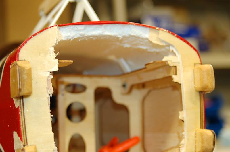

Well, actually "he didn't crash it" is true as a description of the violence of impact.
And it's true that I said the damage came at the end of a flat spin. But I also characterized it as really nothing more than a flat, hard landing. It really wasn't a crash in terms of violence.
What amazed a couple of us experienced guys was that the impact was so minor the cowl took no damage but the firewall was trashed. And that it was obvious the cowl had stopped the engine from going anywhere.
Keep in mind that the upper 1/3 of that firewall is attached to almost nothing. And that for some unimaginable reason, the cross bulkhead that is highest behind the firewall has the center removed. No lie. The picture showing the hole shows a horizontal bulkhead that appears to have it's center "crashed out". There is no center to it. Nothing was crashed out. It's intact from when it was installed. They removed half that crossmember when they laser cut it. There wasn't any "cross" wood in that thing when it was installed. AaaaaMazing!!! They didn't need the room for the gas tank. It's not even close to the firewall. And they certainly did not need to reduce the weight as much as that firewall needed the support. amazing....... The upper third of the firewall is glued to foam basically. Foam covered in 1/16 balsa.

it may also be smart not to PANCAKE it into the ground....................

Funny, but that was exactly the advice I got when we were bringing the sucker back to the pits.
One guy even said that was the shortest landing he'd ever seen.
