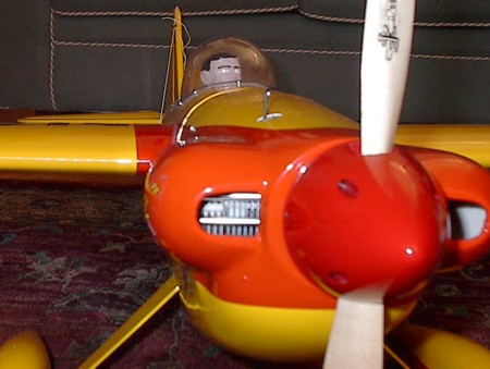

If you haven't started cutting yet, you should really consider mounting the engine inverted to preserve the cowl's nice lines (see attached pic). I used a saito 91 on mine, but I figure the set-up of an OS 91 would be about the same.
FYI, the bolt spacing on the engine mount is perfectly square, so you can simply rotate it 90 degrees and the holes will still line up.

thanks for the comments and pics boys! I like the inverted look nice and clean! Probably helps cooling as well. How does a 4 stroker run inverted? I experimented with a hot knife and it cuts like butter but watch out for the fumes by the smell I think they are caustic.

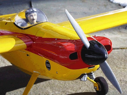

I had an OS .91 4 stroke in my first one. With the engine mounted horizontally, it fit completely within the cowl. I made a 2 inch hole in the bottom of the cowl for an exhaust exit. I suggest you get a flex tube and 90 degree adapter, and use that instead of a muffler.

I've run several 4-strokers inverted w/out any problems. The experts say thats because the plug is offset in the head - not right at the "bottom" like most 2-stroke engines, the plug is less likely to fowl due to fuel/oil accumulating there.
Just test flew my Bucker Jungmann last weekend w/ an inverted Saito 150 and it ran/idled just fine.

Picture of the .91 4stroke

Another pic

Inverted it is! I turned the engine mount and it fit perfect just like you said. I used the hot knife method for the cowl and it is working pretty good. You have to go over it with sandpaper afterwards. All I have to do now is redo the throttle pushrod for when I went inverted it moved the throttle body a little. Anyone have any pics of thier muffler setup on an inverted 4 stroker?
