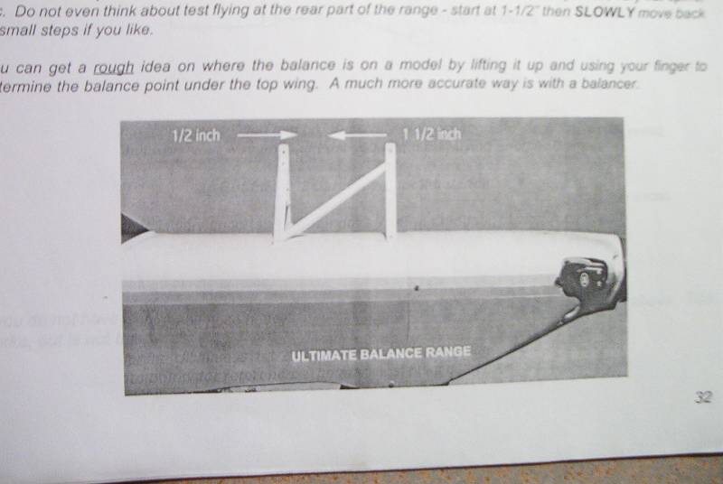

The range is 1/2" to 1-1/2" from the leading edge of the rear cabane.
This is the rear aluminum attachment point for the top wing.
He says start at 1-1/2" I was flying right in the middle. Great airplane!

Thanks guys!! I love these forums. If I understand this correctly, The CG is located under the top wind, 1/2" to 11/2" befind the rearward canbane(post where screw inserts to).

That's 1/2" to 1-1/2" forward of the leading edge of the cabane.
Here's a picture,

Planes are balanced with everything attached, empty fuel tank.
On this plane it's best to use the top, as it's easier.

Once again, thanks for the info.I got the plane balanced. with the new battry. Had to move it back slightly.

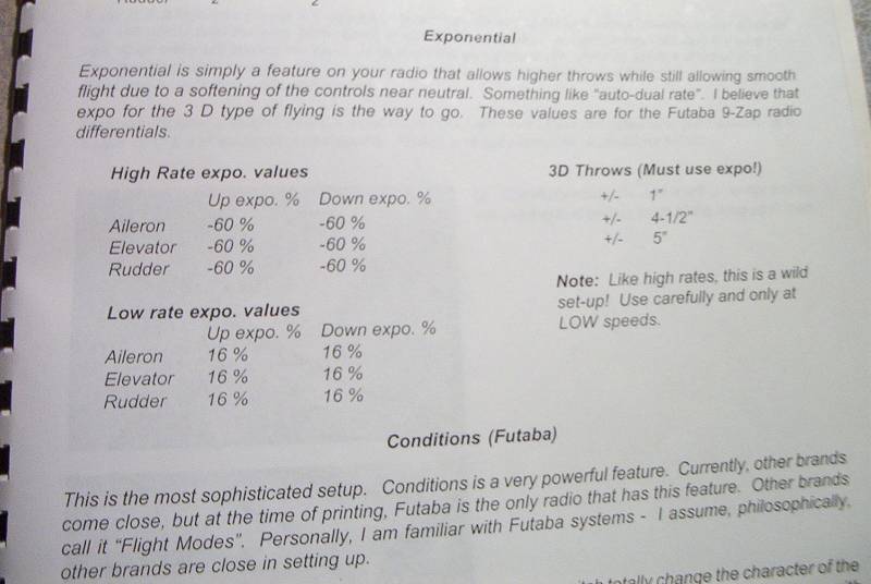

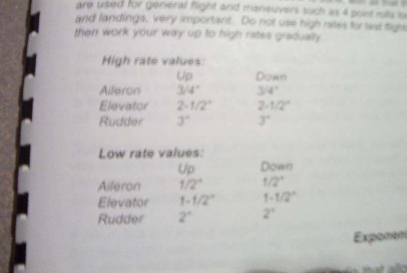

One more question. Could you give me the recommended control throws for both Hi and Low Rates? I have no manual and can not find the specs online. Thanks!!!!!!!!!!!!!

I was hoping you would catch my post about the CG, I did'nt want you to try and fly with it balanced behind the cabane.[X(]
Here's your specs,

Thanks. Hopefully I will fly later this afternoon depending on wind speed. I was close to the throws, but I was way off on the expo. I was suprised to see positive expo on low rates. I have never used positive expo on any od my planes. Thanks,
