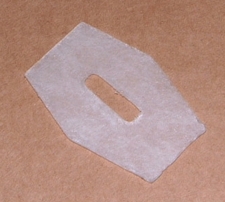

When I assembled a few ARF's years ago, the hinges were always either the flat plastic or round plastic hinges.
So now I'm about to assemble the Alpha 40 ARF... and it's got those CA hinges.
There are a few aspects of the hinge attachment process that are a little unclear to me (at least it sounds unclear in the Alpha40 instructions)...
1) the T-Pins: What is the purpose of these during hinge attachment? The instructions say to pierce the hinges "through the center" with the T-Pins before inserting the hinges. But the hinges have rectangular holes in their centers. There is nothing for the T-Pin to stick into. And what is the purpose of the T-Pins? From the way it's described, they don't appear to temporarily hold the hinges in place in any way or serve any purpose.
2) wicking of CA: About how many drops of CA do you normally end up putting on a single hinge? ... that's not a point of confusion for me necessarily but would be nice to have an idea before doing it.
Obviously the T-Pins have some purpose, so I'll feel silly once someone enlightens me about that, but as yet I don't see what they're for or what exactly to stick them into.

T pins are inserted in the ca hinge to ensure it's centered between the surfaces before you apply the glue.

Well I'll tell you how I do it, others may have different methods....
I use two T-Pins on the larger hinges and this can work if there is a hole in the middle of the hinge, although none of the models I've used CA hinges on have that. I also open up a small area in the wood near the center of the hinge area on the fixed and movable surfaces to allow the CA to penetrate better. This can be done with a small drill bit.
Put the two pins in at the hinge center line where it will flex. Put the hinges into one or the other surface first (I prefer to do the fixed surface) then slide the moving surfact onto the hinges. The T-Pins will go right in the middle providing just a bit of clearance for control movement, as well as let you make sure the hinge is centered and straight.
Then I run the CA down the T-Pins to the hinges. This makes it easy to only run CA on the hinges and not get it all over the surfaces. I just run a couple of drops initially, when it soaks in I run a few more drops. Keep running CA a few drops at a time into the hinges until it no longer wicks into the hinge/wood. Grab the T-Pins with a pair of plyers, give 'em a quick twist and pull them out. If done before the CA sets up with that last application, it fills the holes created by the T-Pins and eliminates any raised area of CA that might have accumulated around the pins.
Let 'em dry good, give them a few flexes to get rid of that bit of surface CA at the flex point and make sure they work. Then you're ready to seal the hinge gaps.

Thanks a lot. Your descriptions cleared this up 100% for me, which is really good, because you only get one chance with CA glue and hinges of this type.
So using two T-Pins when you have the hole in the hinge will not only keep it centered in the slot but also keep it straight. I'll do it that way.
The instructions say to take the T-Pins out and close the gap before dropping in the CA, but if you have materials for sealing the gaps, then leaving them in has advantages for applying the CA.
Thanks this is very helpful
p.s. I included a pic of the hinge and how it has the rectangular hole. Clearly using only one T-Pin in the center (as the instructions say) would not work with these... hence the confusion.

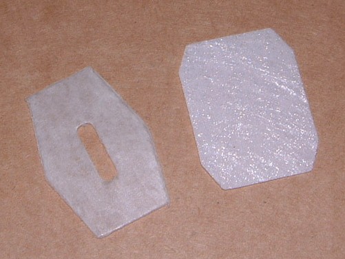

Hi again,
I noticed that I've got one less CA hinge than required (maybe I misplaced it, dunno). So I've ordered a pack of Great Planes brand CA hinges. They should arrive in a couple of days.
The new ones are the exact same size/shape, but they do NOT have the rectangular hole in them.
I've started prepping, but I have not yet CA'd any hinges in place, so I wanted to ask, given a choice, would you rather use CA hinges with or without the rectangular hole?
As da Rock said, the rectangular hole does serve a purpose, but of course you do then have less hinge holding the surface attached. I suppose too that there would be a difference in freedom of flexing?? There are subtle pros and cons I guess.
I've re-attached the pic of the CA hinges that I have currently for reference...

As you have mentioned, the slot has a purpose. How important that is would be open to debate.
After you've accumulated some experience it will be clearer to you how minor most of the details are that have to do with gluing. I've found that as long as I get at least 2 drops of CA on one side and one on the other, every style of CA hinge I've used becomes one with the wood. What I've found depends on my judgement of "2 drops" etc, and won't work for everyone. And it might depend on which brands of CA I've used in the past. But bottom line, is that most techniques match up to the user/developer, but can work for others. And I've found that every quality CA hinge has worked excellently well. Those with the slot and those without.
About the only detail I've found to matter with CA hinges is that the ones that look like slick plastic are to be avoided. Every other type I've seen has a textured look on both sides and has glued perfectly and has lasted as long as I've had the model without failing.
Here's a picture of a model of mine that probably stesses the hinges the most of any I fly often. It was built in the fall of 2005. No hint of failures. But you can bet, it and when there is the opportunity to autopsy it, I'll check how the hinges held. It's the best way to build that experience that helps making these decisions down the road.
The rectangular hole does two things...
- It aids in wicking in the CA
- It lets the control surface move more easily
It does the latter, because there will be slightly less material full of CA to "bend" when the hinge moves.
The drawback to this is that the hinge is slightly weaker, but that difference may not be very important given the overal strength of the material used.... it is far more likely that you'll rip the wing out before you put enough force on the CA hinge to break it.

Thanks for the input. So I'll decide on which one I'd rather use... sounds like both would be great and I guess the Alpha40 has light wing loading anyway.
I received the new hinges today. They are not the same shape as I had thought... they do not taper in on the ends nearly as much, which means they will have even more surface area to bond with the wood.
Here's a pic of them side by side. The new Great Planes hinge is on the right...
