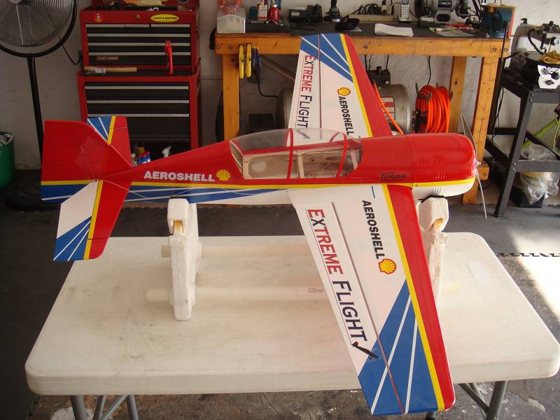

I have one that still needs put together. I've "assembled" it to see how it looks. I might convert it to glow.
I just don't have the time to mess with it as I'm finishing up another project.

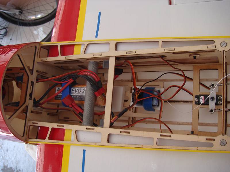

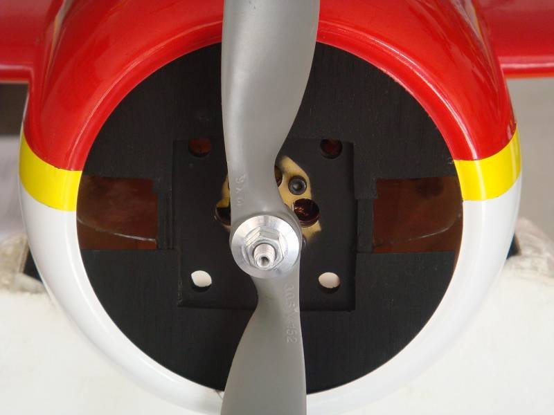

I finished her off in 2 days and she is just like all the Extreme Flight machines very light. Mine is 39oz and running there 820 series big motor with a Castle Creations 45 amp speed control. Spinning a 12 * 6 apc she is pulling 38 amps and 504 watts. The Battery is a Flight Power 1800mah 14.8 Volt. Yes I am also running a CC BEC. Servos are HiTec 65.
The Flight performance is fantastic airborne in inches and she Flys nice and light perfect in low winds.
Hovers at half throttle inverted Harriers and Flat Spins are effortless.
No bad flight characteristics that I have found.
I highly recommend this ARF.
