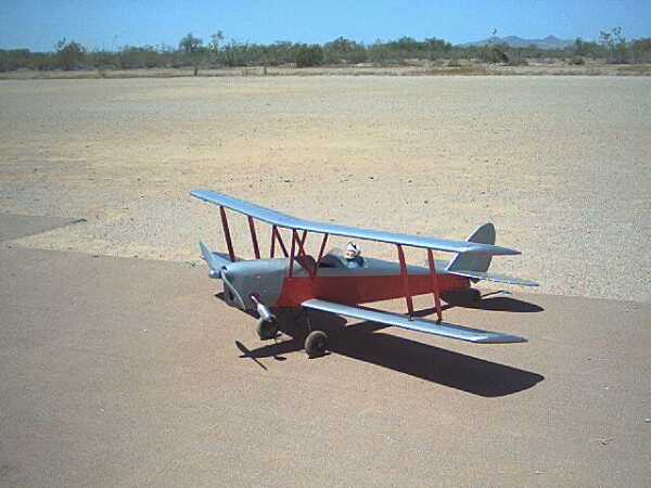

Here's a picture of my second TM. We (my brother and I) recovered it to make it unique.

Dugster - Thanks. I flew the plane last weekend -- the plane seemed right on the cg just having put the battery and receiver where they belonged -- adjusted the throws based on guesses by experienced bipe pilots at the field -- plane flew great on the Magnum 52. Very nice recovering job by you and your brother!
