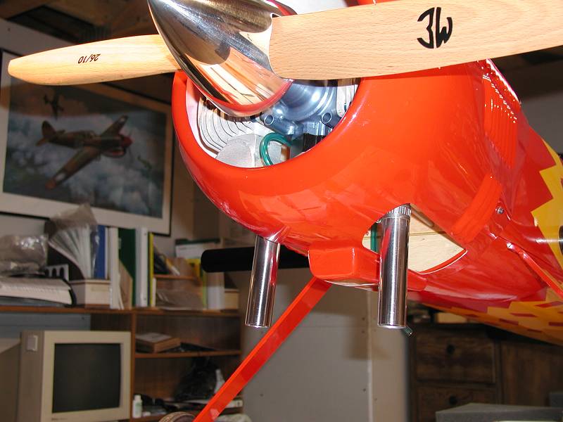

You can't be serious. The JR 4721 and 2721 servos have been the standars in GS models for a long time. I have had both in 35% planes with no problems.
In fact, I have 4 4721's on my H9 Sukhoi ailerons with 8411's in the tail.
It has a BME 102 on it and you need to make a cut out for the one plug cap to stick through. A buddy of mine made a fiberglass blister for mine so that there are no holes in it now except for the mufflers.

If you move the engine forward of the recommended position, the BME 100 class of engines will fit.
The only cut outs needed will be for the exhaust.
If you can route your exhaust under the wing, then no cut outs are needed at all.

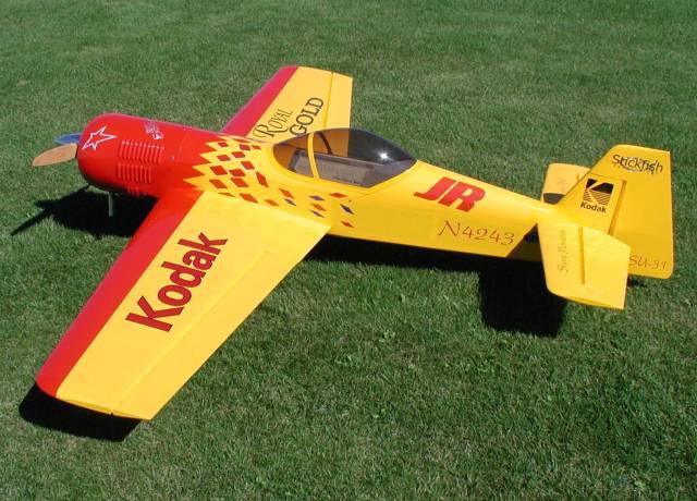

You don't need to cut the cowl for a BME. Mine is just under 24 pounds with a 102 EVO. I have no lead in it. I have a 5 ounce Hitec 5735 in the tail. The CG in the manual is wrong. If you put in a ZDZ 80 and want to fly IMAC you may need to adjust battery location and go with pull-pull on the rudder.
Mike McConville-
[quote]The CG listed in our manual is incorrect. The correct CG location is 13/16" behind the CENTER of the
wing tube for precision flying, and approximately 1/2" to 3/4" behind that for all 3D flying. Balancing
at these locations will make the model balance much easier and should not require any nose weight
unless a very lightweight engine is used. Balancing any farther forward than the above mentioned CG
locations will result in an excessively nose heavy model.
