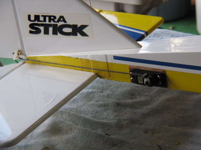

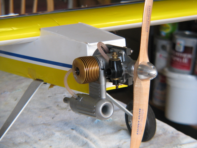

I have the Ultra Stick .40...with a K&B .61 Twister in the nose. I use Airtronics standard 94102's and I've no problems so far. The model is over four years old, and still going strong. These servo's I'm using do not have bearings.
I beefed up my landing gear support, by adding a 3/8th. piece of good aircraft ply to the inside floor of the model, installed my servo's for the rudder and elevator in the rear outside of my model, and added more supports to my fire wall. I then coated every thing from my fire wall rear, on the inside, to the aft wing hold down area...50/50 2hr. epoxy and denatured alcohol, for fuel proofing. I also added brass tubing to my wing hold down dowls, because my wood dowls began to wear, and gave me a loose fit for my wing/fuse hold down issue.
I had a four servo wing for a while, but then...ended up going to a two servo wing in the end. The model is a blast to fly. I also added a different tail wheel assy. to my model.

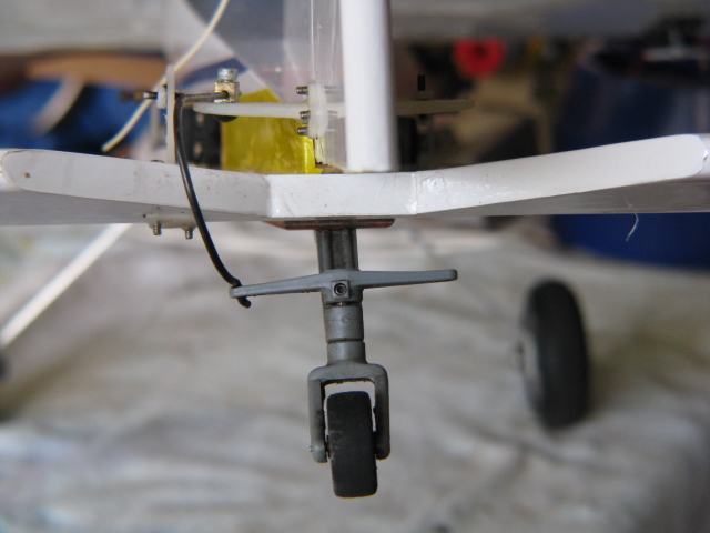

Bob, Could you explain with some detail how your tail wheel hook up works? I want to do that to an US .60 I am building. I can only get the top half of the image to download.

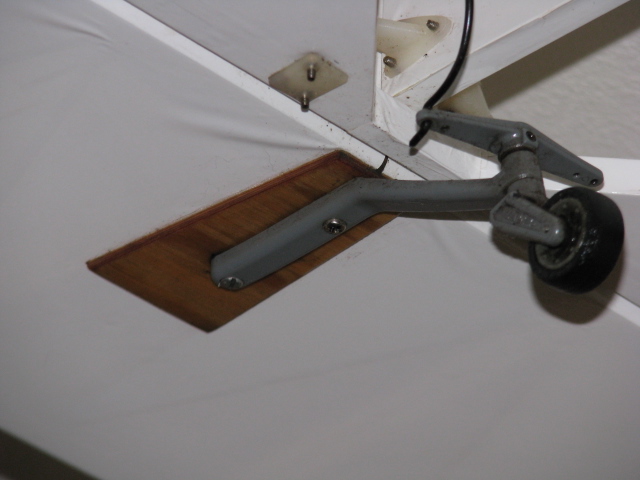

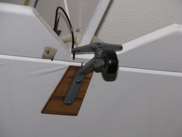

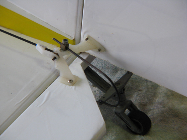

Dear Steve,
The tail hook up is a bit basic, but it sure works. All I did is add a second rudder control horn, to the rudder, and looped wire to connect from the tail wheel stearing arm, to the second control horn on my rudder. I'ts simple, it's easy to dial in and adjust, and it works. Enclosed are a couple of pictures, and if you need more information, just ask.

Bob, How did you connect the Dubro Gear to the horizontal Stab? Did you use the blind nuts supplied with the gear, also did you glue the connectors to the control horns?

Hay Steve,
I believe I used 1/8th. aircraft grade plywood and cut it to shape. I did this before I installed my rudder and elevator...and I also put a doubler inside the fuse. Its easy before you glue your stab and rudder in and I used he same blind nuts that came with the tail wheel assy. This has never failed me so far...even after a real hard landing. My model was going to come out nose heavy as it was, with the .61 installed. That is why I also placed my rudder and elevator servo's in the tail-for balance, and easy to check here too. I needed a model I could rely on, easy to trim, and fun to fly. You just can't beat an ugly stick, and I don't care who makes it. The hanger 9 issue of the model is very well done, and it's been well used, rode hard, and keeps on flying.
