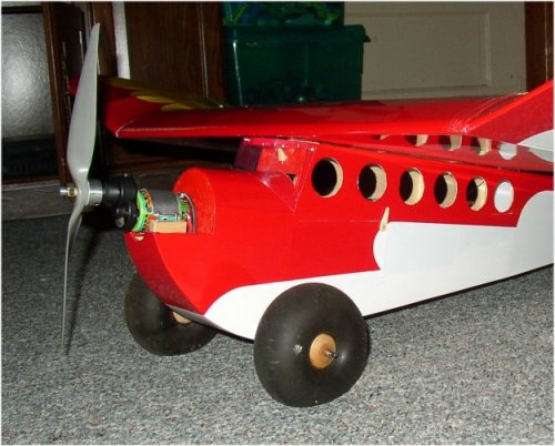

OK guys.....sorry I have been very busy! Here is the Bee with the Master Airscrew box on it. It did not work well....barely could stay in the air with a 2,400 battery and a 40 amp Great planes ESC. I was using the Green Machine reverse rotation motor. I am thinking maybe it would have been better with a 60 amp ESC?

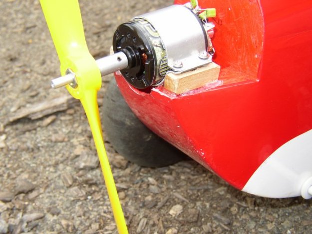

So......from there I decided to try it with a magnetic Mahem motor direct reverse rotation direct drive with not any more luck. Then I wnt to the Trinity black Onyx.......direct drive and could get three minutes with the plane at full throttle. Just way too heavy!

Now remember....I bashed up the wing two or three times and at this point I am tired of the electric business! The only thing that I wanted to put on the plane was an LA 25. I was concidering a Norvell .09 but it seems heavy compared to the displacement. The LA 15 was on another plane so I dropped my LA 25 onto the plane and it is a lot of fun!!!! I will be flying in the morning and can not wait! Anyone know or have any info on a product called the "Quiet pipe"? It is made of light weight slicon or something like that? I used to see it advertised mut have not seen it in a while. Any knowledge out there of this product?
