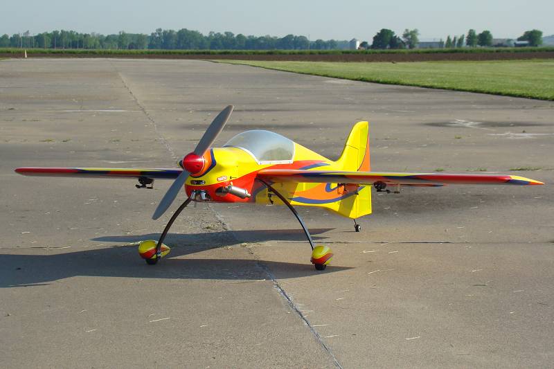

ORIGINAL: summerwind
i want to get this plane and put a Laser .80 in it, but i have been reading all the negativity on it in regards to the covering. is it a kit that i should avoid?
I have this plane with a Saito .82 up front swinging an APC 14X4W prop. I'm not a 3D flyer but it is a very nice flying plane. I re-shrunk the covering and all of the sharpe edges I hit with clear nail polish. I have about a dozen flights on the plane and haven't seen anything bad happening yet with the covering. The covering seems to hold up very well in the sun and it's very visable in the air. I used the Graphtec CF gear and it's working out fine. I fly off of concrete so I may not have had a problem with the stock gear unless I went somewhere else that had a grass field only. TH has this plane now for $159.99 and with their specials you should be able to get it for a good price.

GarySS,
As I do with all ARF's, re-shrink the covering and seal all areas as needed before you get fuel on the plane. I've been checking it over after every trip to the field to make sure nothing is coming loose. So far so good. The plane flys really nice with the Saito .82
