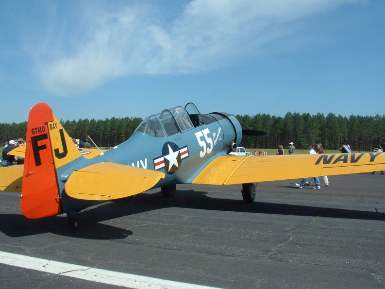

Just wanted to let you guys know that they Hanger 9 AT-6 was a rendition of Fred Johnson's full size AT-6. I saw it fly at a airshow here in Florida and thought you guys might like to see a pic of the real one the model was based on!
