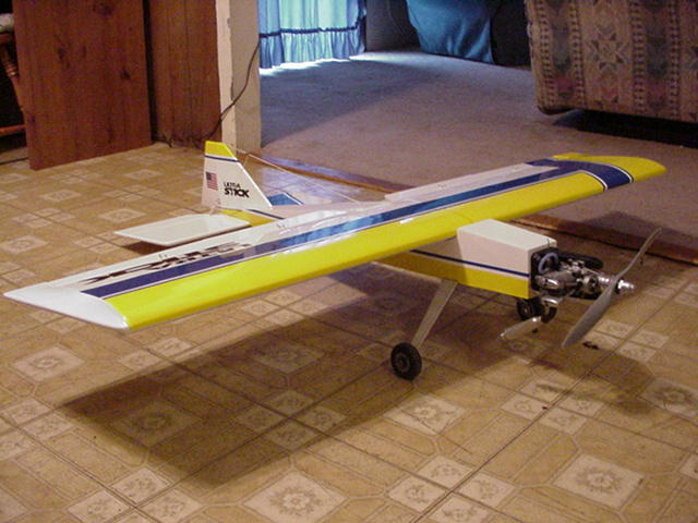

Default H9 UltraStick .40 Is .46 enough?
I have a Saito 80 4 stroke on the nose of mine. One awsome combo. Here's a pic of mine.

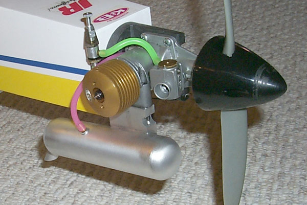

For what its worth...I am just finishing my UltraStick with a K&B 61 and it looks like it will balance without adding any weight to the tail. The K&B is very light and I used a Dave Brown glass filled 40 size engine mount that fit the K&B perfectly. I also used a custom and very light muffler from Bisson. http://bissonmufflers.com
I'll put some pics up tommorrow if you like.

Default That picture I promised
Ultrastick with K&B 61, Dave Brown glass filled mount (40 size) and custom Bisson muffler with no baffles and a shaved pipe.
To my surprise it is balancing with no extra weight in the tail.
The K&B weight is 22 oz on their site. Not sure if that's with the stock muffler or not. I think it is with the muffler.

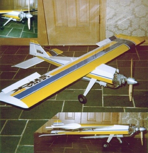

My OS 91-FX has found a home in an US40. I cannot say anything about hovering, but it has power to spare yet slows down nicely when needed.

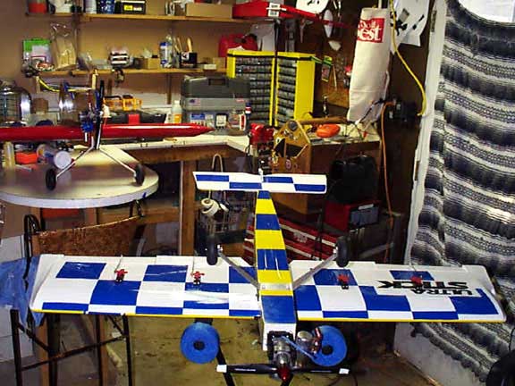

Old 03-24-2002 | 01:42 PM
Posts: 2,924
From: Nashville, TN
Default enya .8-0
Here is my US .40 with an Enya .80 on it. I just pulled off the 7 ounce pitts muffler (jeez!) and am waiting on a 3 ounce muffler. With the 7 ounce muffler she needed 6 ounces on the tail and weighed in at 7 lbs which seems excessive because the manual say it should weigh around 6 lbs. I did reinforce it a lot but not that much! I just bought an 1100 mah rx battery and am installing that in the tail today. I might put a servo back there as well if it still doesn't come out right.
