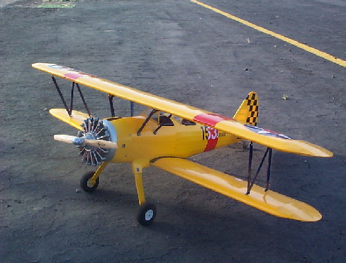

BTW, here is a picture of my Kyosho Stearman. As you can see I've converted from the Army version to the Navy version. This particular plane is modeled after the Stearman flown by Cdm. Harmon Rabb on JAG.
Mark

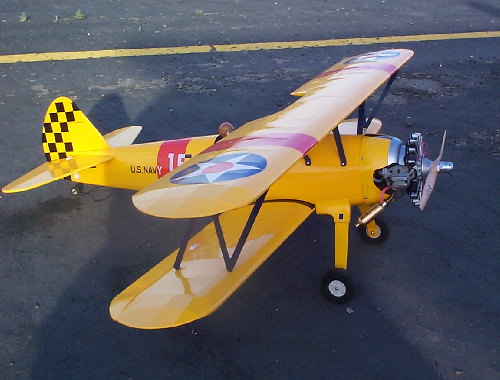

Here is another picture.
