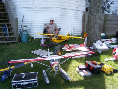

This may be a different Beaver?

Hey Capt'n,
Sure looks like my beaver, only with floats. How does it handle with floats?
What battery are you using?
Man I wish Horizon would hurry up and ship. Been waiting too long for my replacement. My flying buddy and his Corsair tore right through my wing, and the crash site was pavemnet. So, not much was left of my airplane. Now he wants a Canadian flag "Kill sticker".
It is a great looking airplane, both on the ground (or water) and in the air.

It was not my beaver, I was at a small float fly-in. The Beaver did fly well. It was the maiden flight I got to see. To me it looked like a very easy airplane to fly. Sure is a pretty plane up close. I even took video of the flight. I think I will watch the whole video again...it was a nice fly-in on a small lake. Regards Capt,n
