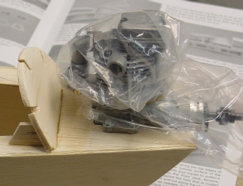

I don’t know how well that Sato engine will fit on the Slowpoke ARF. I put a Magnum 52 4-stroke on mine, but the carburetor hit the fire wall, so I sloped it back to make it Magnum fit. It turned out very well, as you can see. I haven’t flown it yet, but I just thought you should know what the engine fit may be a problem w/ the ARF. I would love to know how that turned out w/ the Sato. I emailed Great Planes about it and they said that all there planes were designed around OS engines. Good luck!

Old 05-20-2002 | 09:59 PM
Posts: 42
From: MA
Default slowpoke .40 ARF
thanks for your input regarding engine installation. have not started as yet on new slowpoke, but trial fit suggests Saito .50 will have to be installed about 1/4 inch or slightly more forward of
original specs. hope this will offset somewhat the tendency of the poke to be tail heavy. will keep you informed of progress at this site. and hope you will exchange your experiences.
