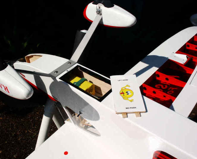

Have finished my Rascal 40. Setup is as follows:
Mega 22/30/4 with Mega 2:1 gear box
APC-E 14 X 10 Prop
16 Sanyo RC 2400 Pack with Sermos connectors
Jeti Gold 40-3P Opto ESC with Sermos connectors Batt.side
Sanyo 1000mah RX pack
RTF weight is 7 lbs. 1 oz. or 3248 grams
CG balanced first time at indicated 3/3/8ths from LE
Today will use my astro whatt meter to run static amp test.
Hopefully, all of the above will work well together.
Will try and attach a few pictures of the Rascal 40
LNL.

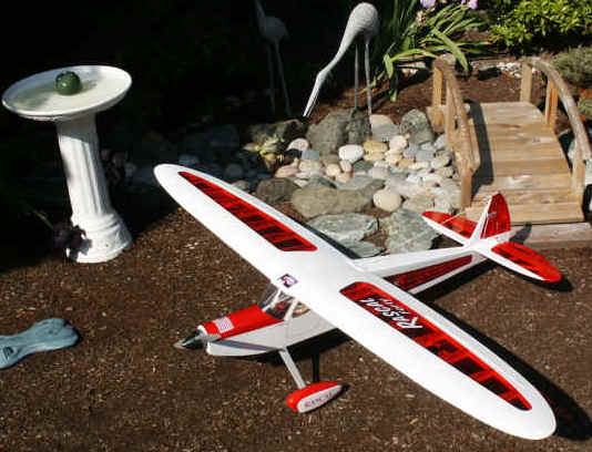

Old 06-03-2003 | 02:49 PM
LNL
Posts: 67
From: Oak Harbor, Whidbey Island, WA
Default Rascal 40 Electric Conversion
Another view of Rascal

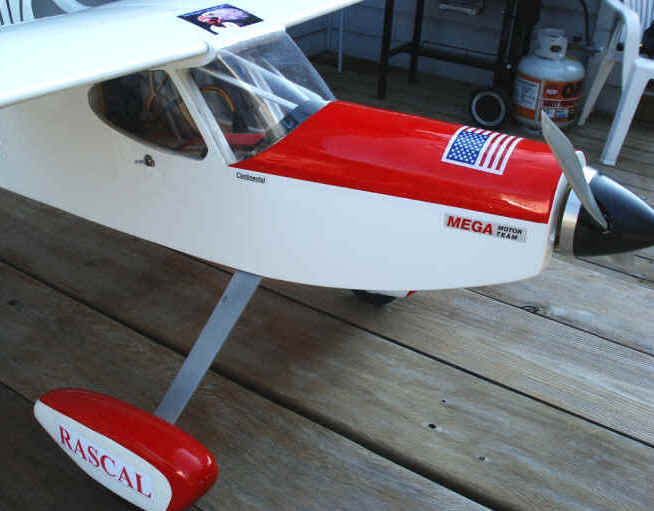

Old 06-03-2003 | 02:51 PM
LNL
Posts: 67
3/4 View of Rascal

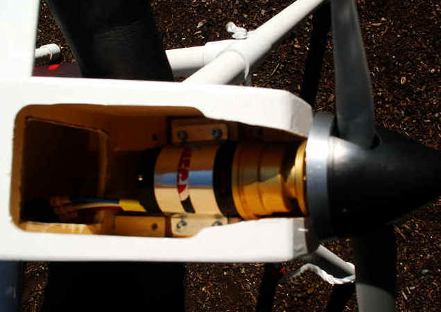

Old 06-03-2003 | 02:54 PM
LNL
Posts: 67
Mega 22/30/4 motor mounted with clam shells
Old 06-03-2003 | 02:57 PM
LNL
Posts: 67
Battery Hatch, lite ply battery tray with velcro strip and strap

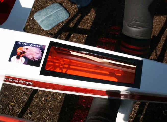

Old 06-03-2003 | 03:21 PM
LNL
Posts: 67
Air flow opening bottom rear of fuselage
