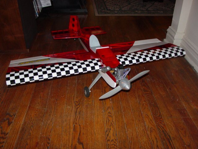

Today was the first day I've really flown my ultimate in ambiant temps above 60 degrees F (it was in the mid 80's today). Anyhow, the YS 63 kept on overheating......and it deffinatly wasn't due to a lean run. It's got to be the lack of airflow over the engine. I haven't done anything to the cowl other than cut the holes for the exhaust and head of the engine to exit.
i'm thinking I should probably expand the inlet holes..... but what about where the air exits???? Is the slot at the bottom/end of the cowl enough for hot air to escape??
Im thinking that with the engine mounted inverted, there would have been signifigantly better cooling..... (but looks suffer)
WHat do you guys think??

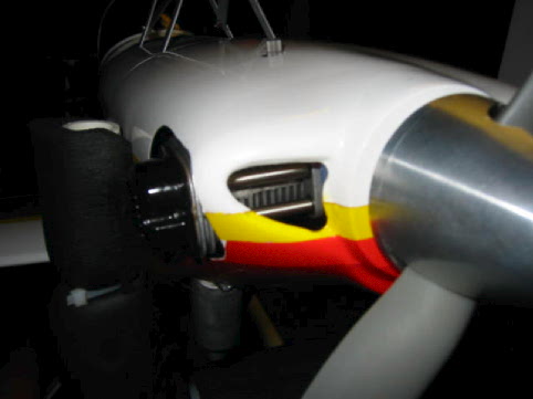

I also had an overheating problem with my Ultimate .40 / YS .63 combination. My engine is mounted sideways, and the cowl was originally cut for the valve cover ONLY.
I widened the curved opening at the bottom-rear of the cowl by about 3/16".
It now runs strong, with no overheating tendencies at all.
I can post a picture if necessary.

It was such a good day to fly today that I just went and cut a larger arc in the bottom/rear of the cowl for better hot air exit, and I expanded the two intake holes a little bit more.... It was in the mid 80's and no overheating problems!

It was such a good day to fly today that I just went and cut a larger arc in the bottom/rear of the cowl for better hot air exit...
That's pretty much what I did. I didn't change the size of the intake holes, though. No need.
The temperature at our field is generally in the mid-eighties. I've had no overheating issues since I opened up the cowl.

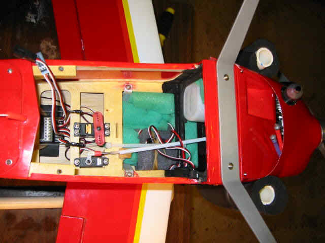

for Kevin3D. Start to finish.
Specs:
Power is a YS .63 with an OS .70 muffler. Servos are Hitec 5245s throughout, with an HS-225 on the throttle. 1200 mAh NIMH pack.
Mods:
- replaced the stock tank with a 12oz. Dubro.
- installed a pair of fuel dots in the cowl.
- placed the elevator and rudder servos in-line with each other to simplify the pull-pull geometry. I raised the rudder servo by approx. 1/2".
- CF main landing gear from Moose. The stock aluminum gear was a little too soft for my liking.
- DP tailwheel instead of the stock unit. This raises the tail and keeps landing stresses off the rudder.
the beginning...
I was lucky - there was no damage to the plane.
The radio compartment:
The rx is stuffed up in the nose above the fuel tank.
The engine compartment:
The OS .70 and YS .53/.63 use the same thread for their exhaust bits. The combination of the straight YS header and the OS muffler fit perfectly without requiring an enormous hole in the cowl.
The finished product:
No decals - they were missing from my kit.

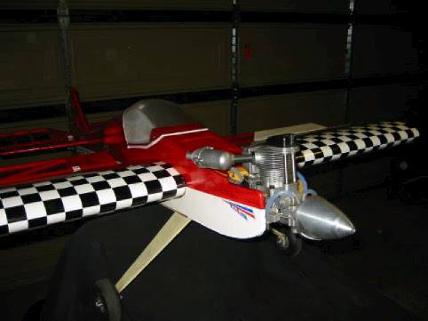

Here's mine, along with what I did for the cooling problem....

It's pretty much the twin to visioneers... 5245's on the ailerons, elevator and rudder, and a HS 80 on the throtle
